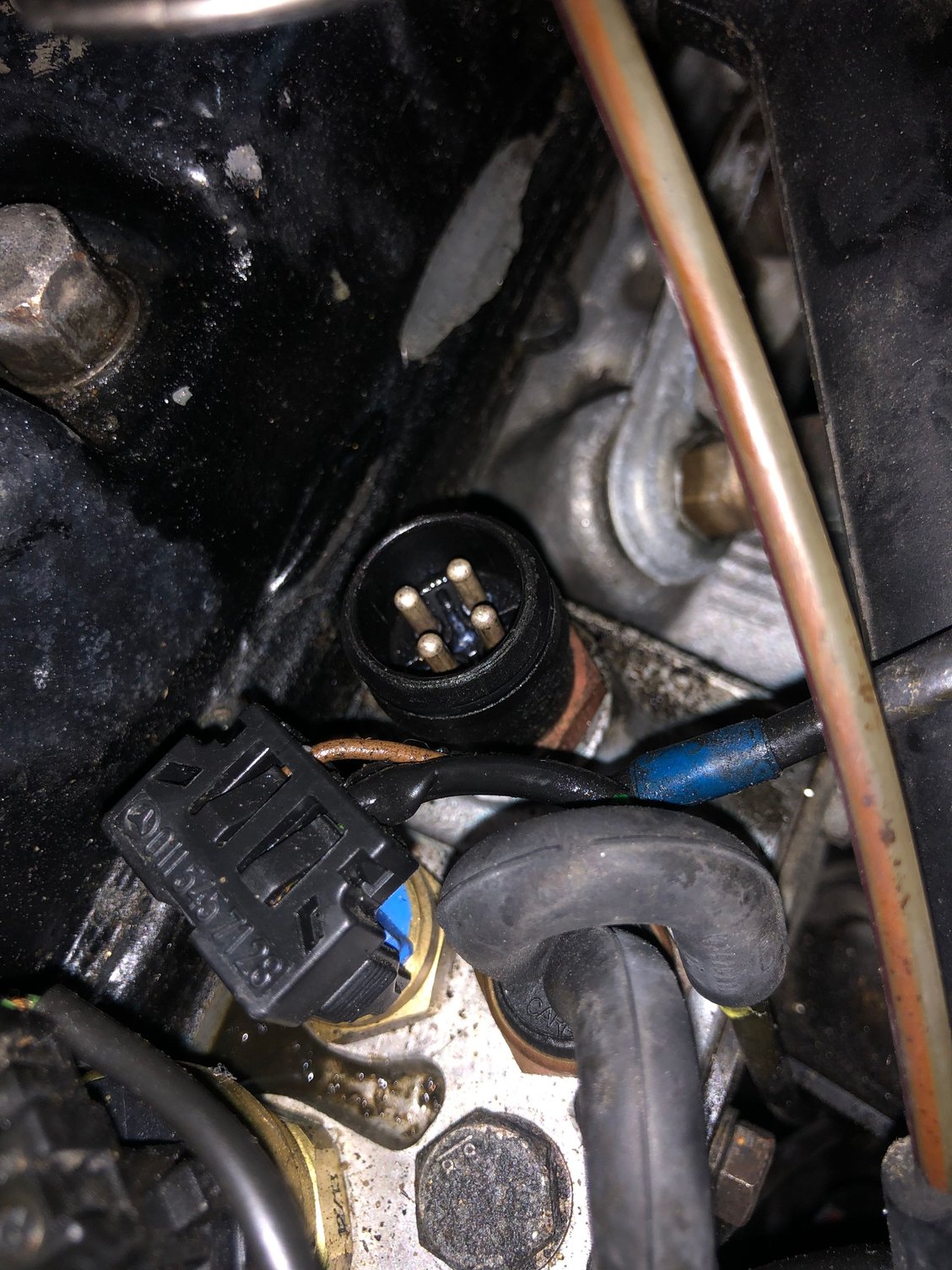

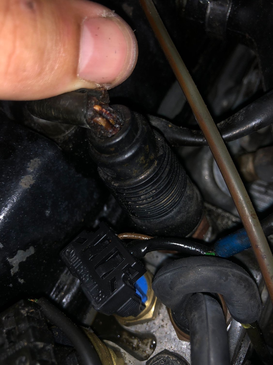

is this plug with the cracked wiring the coolant temp sensor you are referring to? This would explain why my symptoms seem erratic? Some days it's fine, others it's not.
the car is operating in closed loop. New oxygen sensor and multimeter confirms closed

That indeed is the coolant temp sensor. One pair goes to the ECU, the other pair goes to your instrument cluster.
The cracked insulator could be a problem but not necessarily.
Does you temp gauge in the instrument panel behave erratically ever? Perhaps that pair is OK?
If the temp sensor is out of range that should throw a code (I believe), do you have a OBD-1 code reader?

  • the sensor did go through the parts washer when the head was machined so it is suspect. I bought a new one ($20) and will try to take the plug apart and repair 1265403081. Plug is $90 at dealer!!

The plug is one part you can buy at the junk yard. $5 at pick and pull and it is not a wear item. Never seen one as bad as yours. Mine is original.
Good luck and patience with the repair Nate.
This may not be your problem but it sure needs to repair.

I think that was the problem!
I went to the junkyard today and got a new wiring connector and sensor. Soldered it in and seems to have made a difference!
Unlike most of the other MB connectors, this one seems to be fused together and unrepairable. Must replace
Starts much quicker. Seems to have more power based on a few hours of driving.
I can't believe this little sensor could cause that as it was still running in closed loop mode?
This all does make sense now, for years the car would run great one day and **** the next, totally unpredictable.
Thank you for the suggestion!
