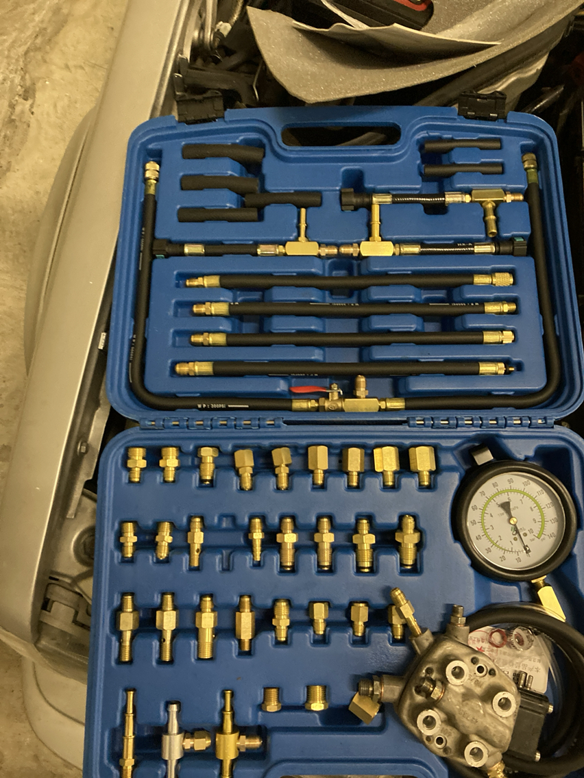

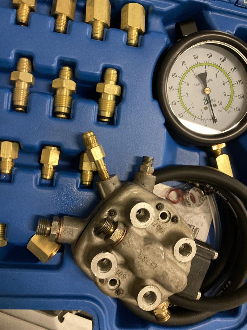

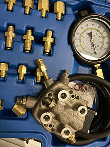

One more thing. At this point you do need a dual input fuel pressure gauge set-up to check system and chamber pressures and make adjustments. I assume you do not have one, they are ~$100 in the US, not sure about Japan, probably at least twice the price there.
You need to acquire one of these, borrow or purchase one. I'm attaching my unit photo's for reference

Good. If you need help with it let me know. Hopefully the fittings are included. You can use my measurement set-up in the photo's.
The gauge readings there is what you need. System pressure ~5.5bar , control pressure 0.4bar lower. System works on a pressure differential.

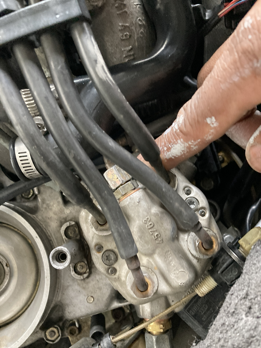

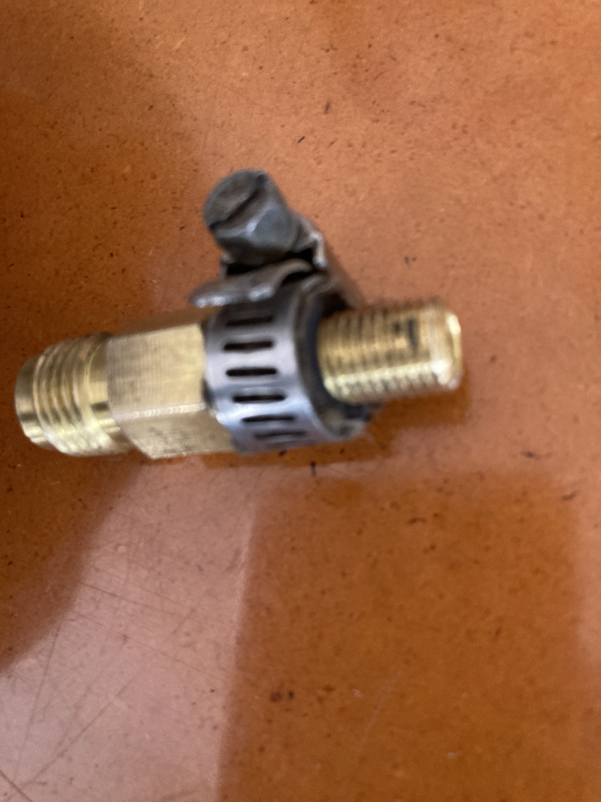

Only 1 attachment kinda works. Gonna have to borrow another set
Attached Thumbnails 2.5 16v stalling-photo661.jpg   2.5 16v stalling-photo128.jpg

Like I mentioned you will have to do a calibration. A bit more work. You will need to measure the same (system) pressure with both meters and see if they are equal.
If not you will have to correct for that when you are taking dual readings simultaneously.
BTW, that fuel pressure gauge scale is a bit too large, you will be trying to measure two small tick marks in that. Let's see what you end up with.

Need to do a bit of fiddling to get the lower attachment to fit.

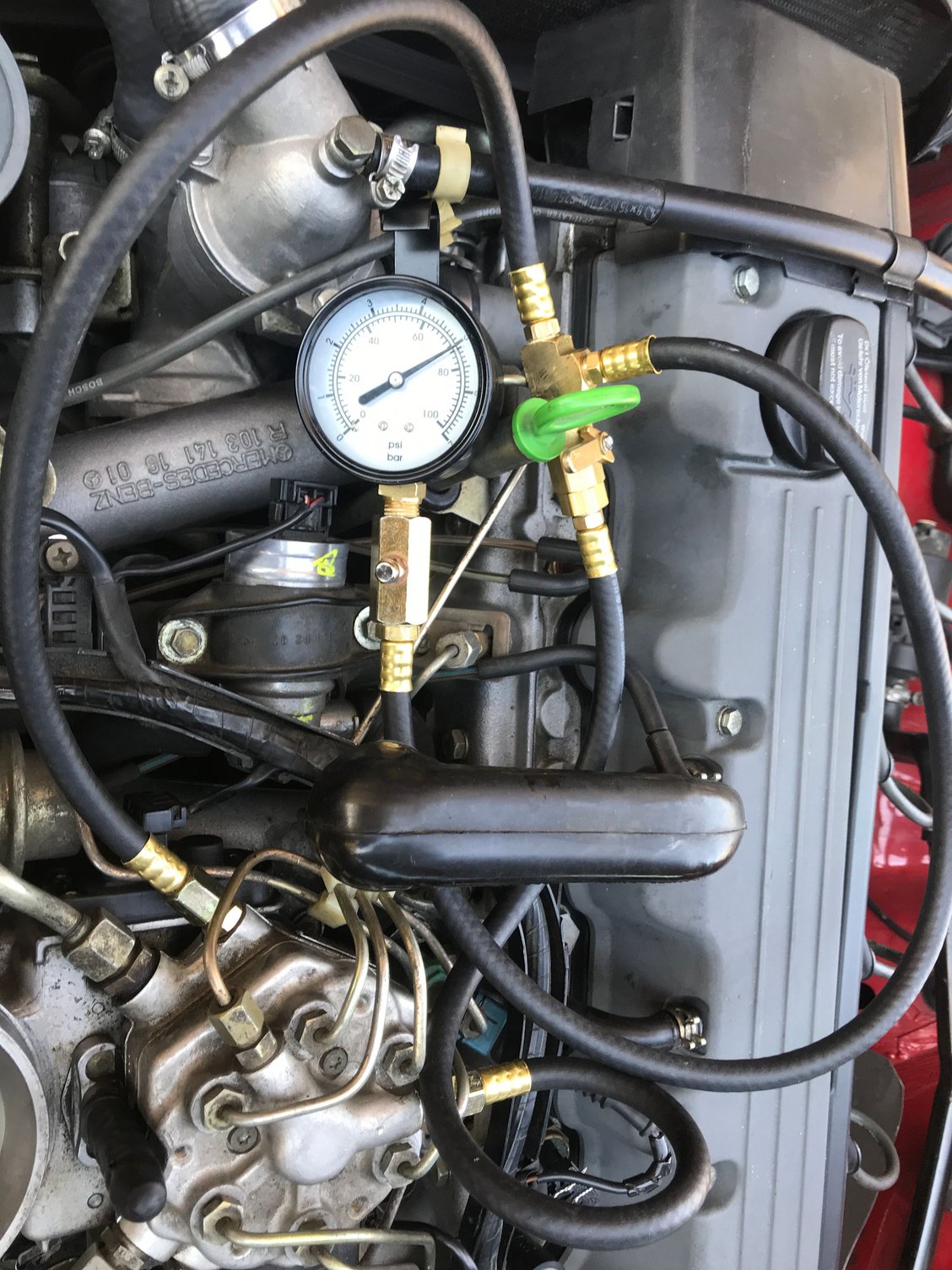

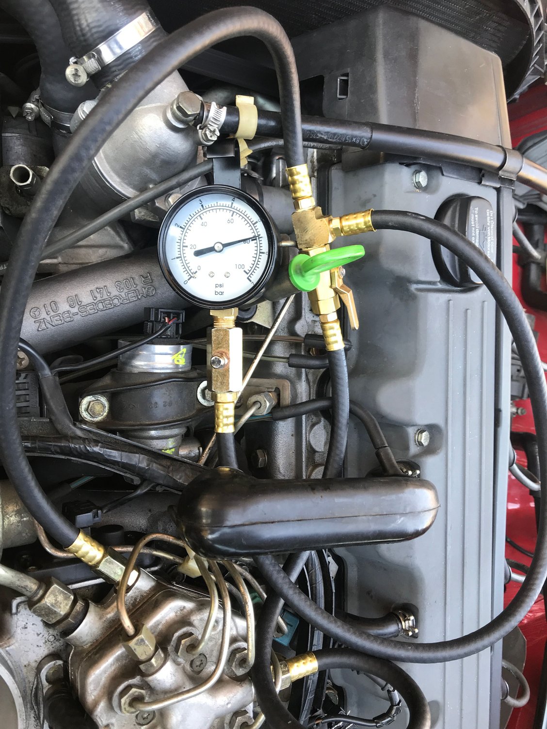

Only one way to check if this works

Yeah, getting the attachments to work for a Bosch FD is a lot of hassle. That is why the gauge I sent you is perfect. It is all plug and play.
No adjustments/modifications needed for the fittings.
All I know is putting a rubber fuel hose on a threaded attachment with a clamp will not work. It will leak.

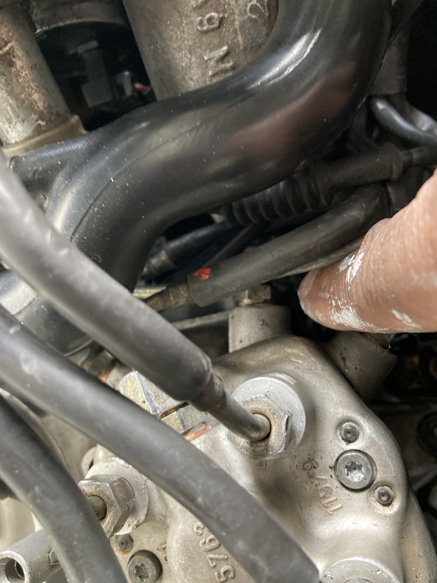

Even if it could work it won't clear the intake manifold. More begging and borrowing tomorrow.

Just curious was the part under the rubber in that fitting photo (the shank) threaded or flat? If it was flat it would work and you can cut off the threaded part of the brass easily to give you more room.
BTW, I'm surprised the Fuel injector connections to the FD are flexible rubber in your 16V. They are all metal in 12V and 8V.

It's not mine so I won't cut anything.
I managed it find another shorter adapter but the thread pitch was different so it leaked.

Visited 3 shops today.
None had the proper fitting.
One shop recommended taking it to possibly the last Benz dealer familiar with these older cars.
The specialist is knee deep and won't lend me his gauge. So......
My only way forward is to keep fiddling or take it to the dealer.
