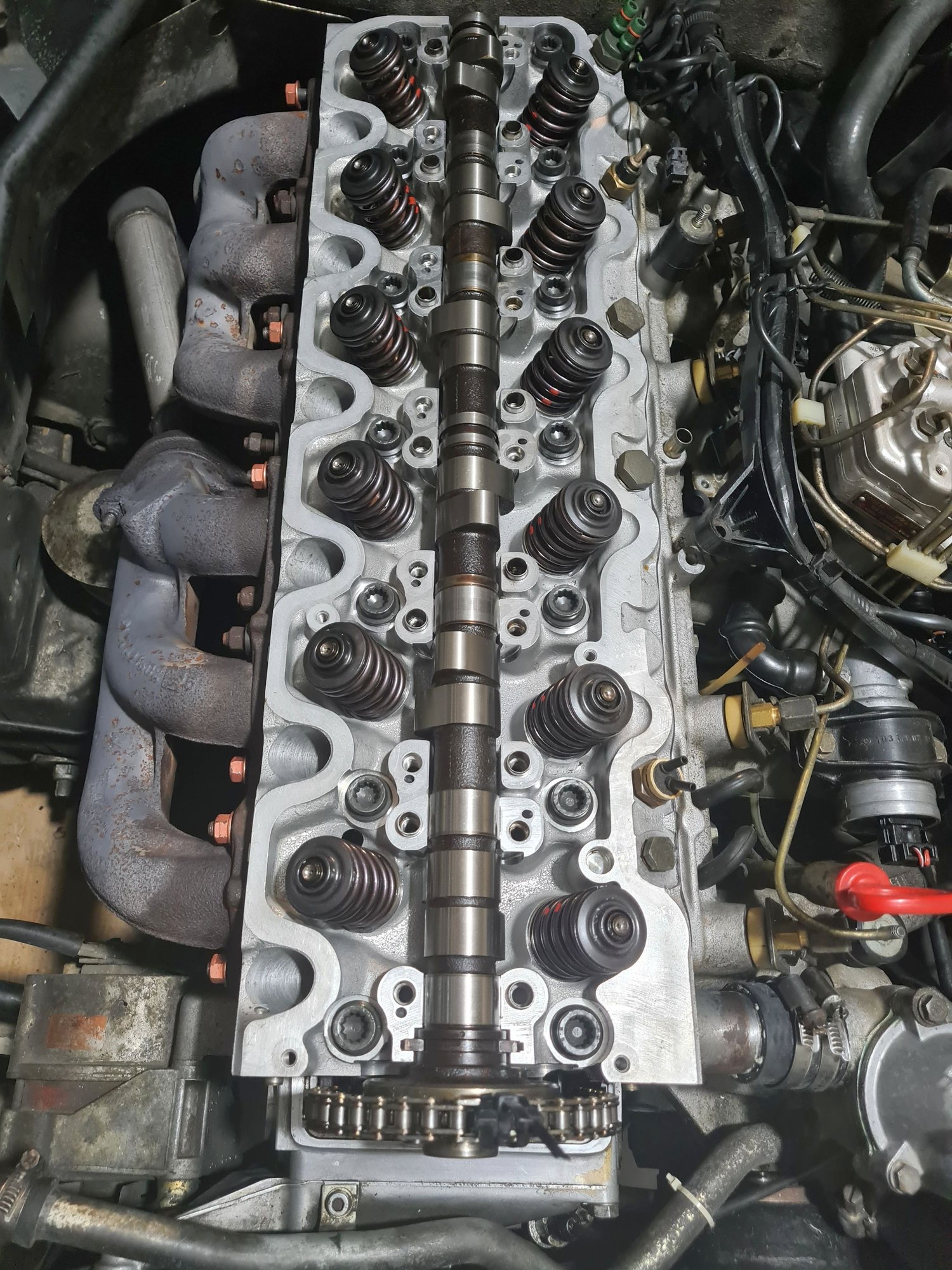

so I got the head back from the machine shop looking like new (well as new as possible for a 30yo ) and I decided Id put it all back together
This is cleaned, checked and milled
I also replaced the stock springs with Dbilas hardended 13lift springs, new valve seals, even new valve guides

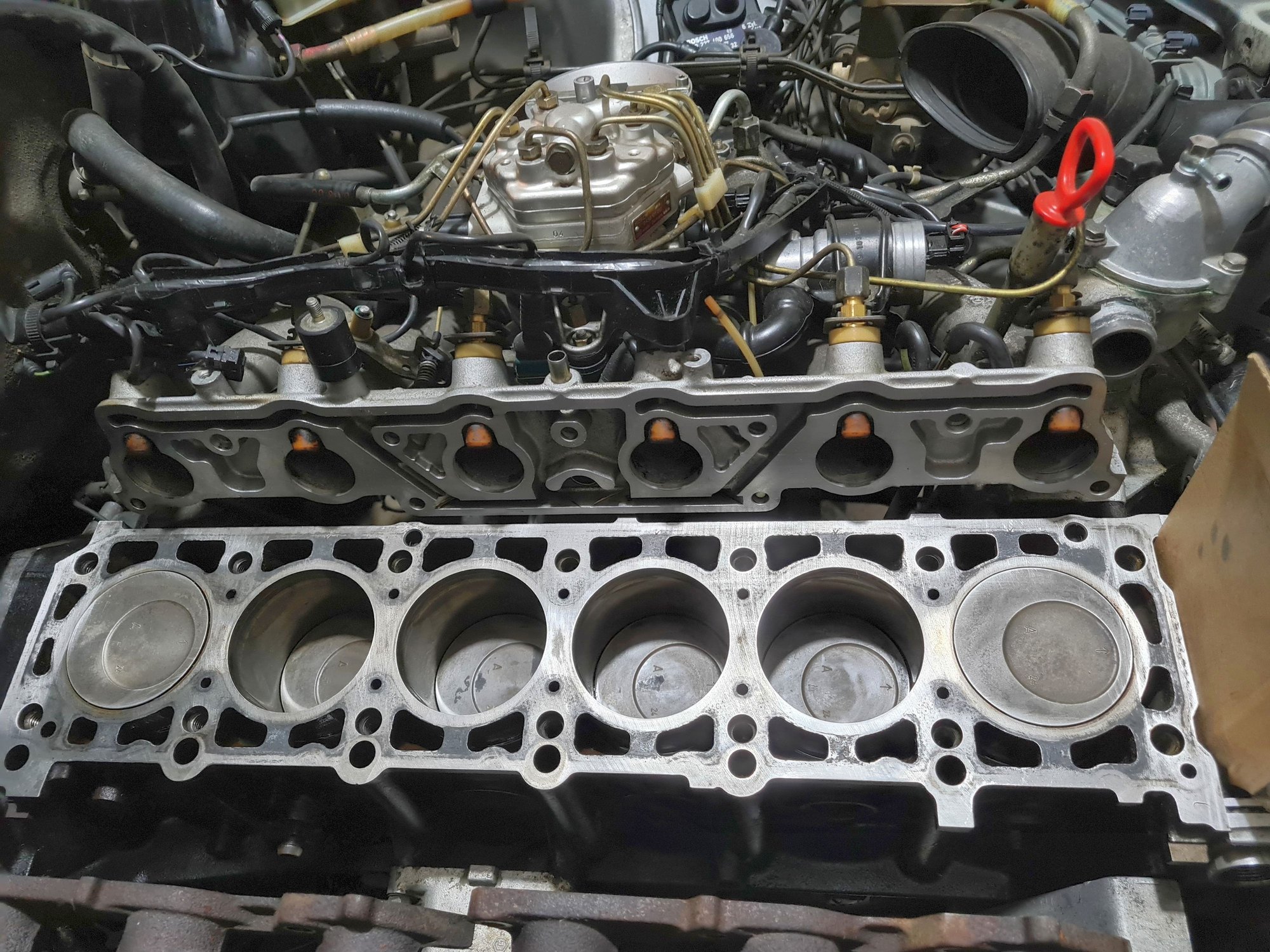

This is the block in the final state, I stopped sanding after our talks here and on advice of a friend I just used a gasket scraper + a nylon brush on a dremel to cleanup and leave it be
Must say car's quite happy and so am I
note the SBC rumble on idle lol, cam + exhaust, a bit much at times, but I can quiet down the exhaust if need be
