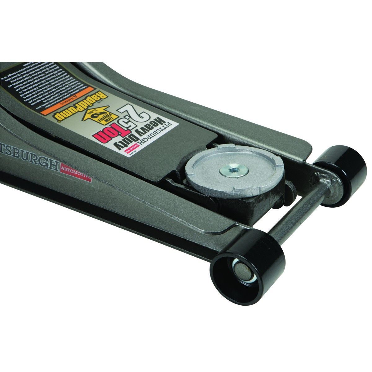

For the front jack point you dont even need anything special. Just get a jack with a cup big enough to have the whole entire pad on it. I use this from harborfreight.
It has a little lip that snags the lifting pad in case it slides. By putting one of those puck style adapters you risk it slipping off in my opinion. As for the jackstands the main thing is you want it to be narrow enough to mate into the recess of the jack pad. If its too wide and hits the walls then no bueno and cut it. heres a nice jackstand for it but i was too cheap to buy it lmao.
If it mates nicely youre good. I do like the plastic covering for the jackstands though

and dont forget our car is over 4000 lbs you want a beefy jack not like the one in that pic. Too small in my opinion
2.5 ton is the minimum 3 ton if you can

Nick...I have one that looks like your Harbor Freight. Ill send some pics later
