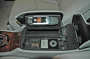

Put it where you want it. My installation is quite different from the MB iPod kit (which isn't available for my car). My center console is quite different from yours, and there are no instructions as to how to place these retrofits - you do the best you can.
I chose to do mine this way, and yes, I had to drill holes:
Attached Thumbnails ipod integration - where do you route the ipod cable?-dsc_3406.jpg
I like your setup in the center console. When you say "drill" do you actually use the drill bit to open a hole or it's a generic term for making a hole? I suppose I can widen the hole that's already in my center console with either a drill bit or the dremel tool. I just worry about the dust. Even using saw, there will be saw dust ....
In fact I used a drill. Verrry carefully. Could just as well have used a Dremel tool, and wouldn't argue against it.
The one thing I did not do was widen any holes that already had wiring. Not a good approach with either tool. I cut new holes.
