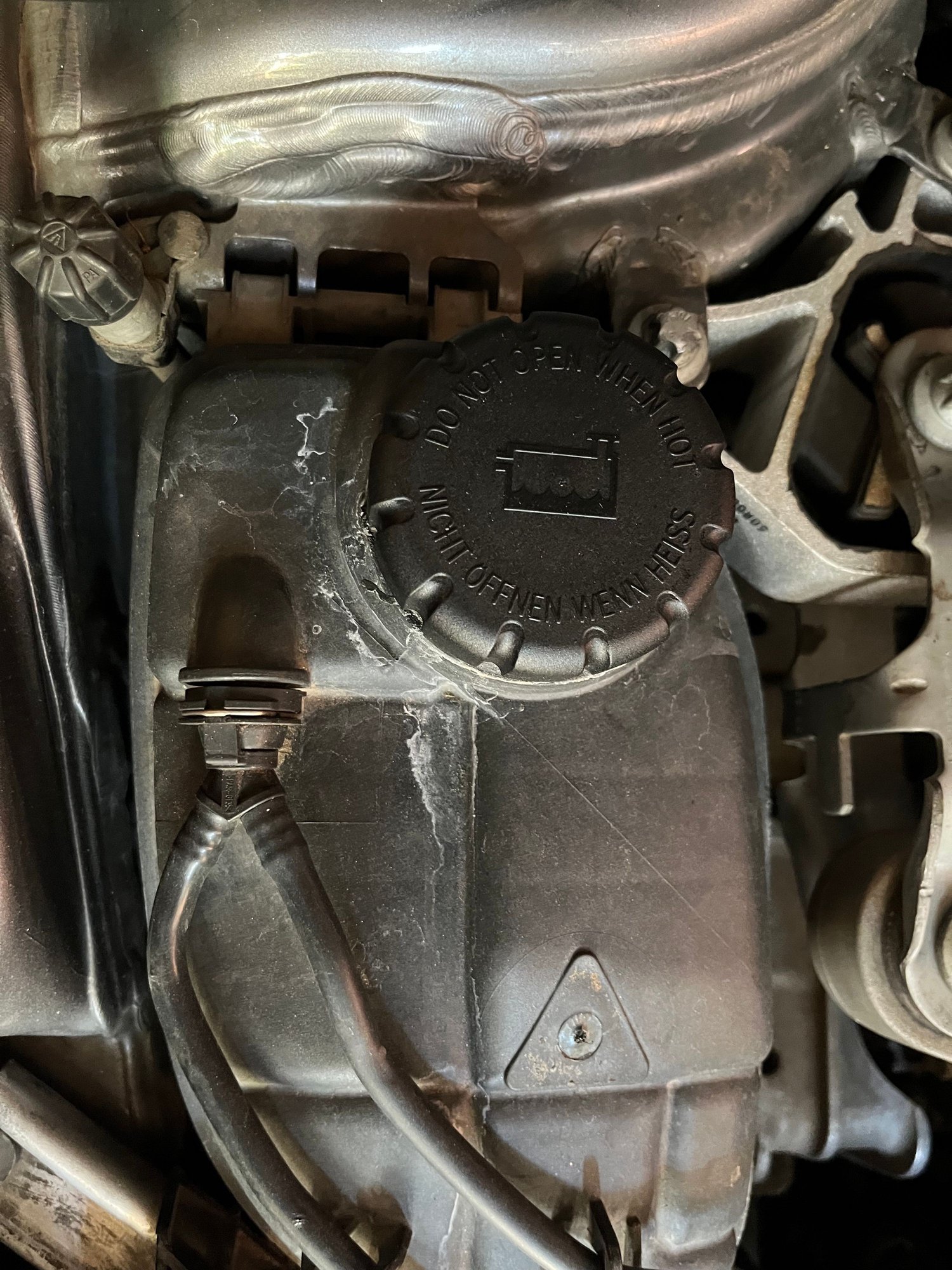

My 2015 w246 B class B200 CDI run 1,05,000 kms has been suffering from coolant loss from the past 7000kms. Twice on highway runs I got low coolant warning and had to top up. Recently service was done 1300 kms back and coolant cap was replaced as no leak could be identified. But today I got the coolant low warning again. The coolant reservoir shows signs of spilled coolant.
There is no identifiable leak from the radiator or any of the hoses. There is no white smoke from the exhaust. I do get a bit of black smoke on hard acceleration which I assume is normal.
Should I change the tank or open up the engine looking for a leak? Or look into the hoses going behind the wheel well?

Mine stopped after changing the coolant reservoir and cap. There was a leak from the cap.
