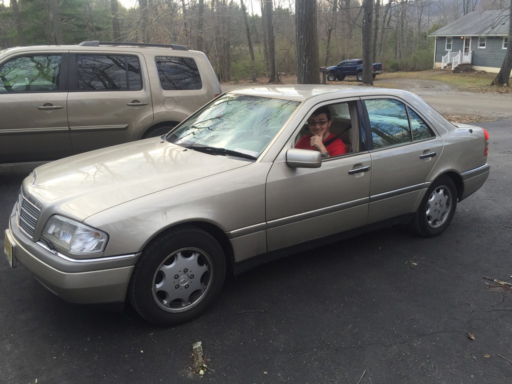

I started this over on the "new guy" thread, but I have some detailed questions and was directed here. I've had an '84 300SD and an '86 560SEL so I'm a little familiar with MB.
This is my son's first car, a W202 1994 C280.
'94 C280 - Needs a little help-5134e8b7-1fb0-4a92-808c-0163e11c248a_zpszvzezdsk.jpg
It has only 107,000 miles and is clean, tight and rust free. Other than the obligatory weeping headliner, the interior is sparkling clean. It had a disintegrating engine bay wiring harness and the PO replaced it as well as the trans harness. He also replaced spark plugs and did a few other things. Supposedly he is a certified Mercedes tech, but a little young to be too experienced.

Do my eyes decieve me or does the color change between front and back doors?

Yeah, it looks like the back door had some paint work. It doesn't match the front door or QP.
The previous owner took the hit and replaced the engine harness and trans harness. The shop I took it too checked it out. Seems like it's a common to find the wrong harness on these cars.
