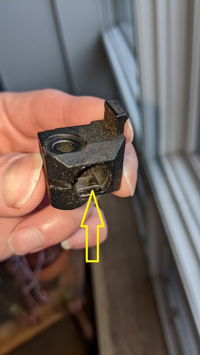

I initially bought the part on Ebay and there was a defect inside the area that inserts into the main unit or trunc: there may be indeed a little metal plate creating a protruding edge that might be too thick and thus could prevent the full insertion.
The 2nd part I bought did not have the metal plate so no issue.
Unfortunately, Ebay had a confusing return process and screw me on the shipping cost which was essentially the cost of the part I bought.
Here is a photo of the defectuous part with the arrowhead showing the metal edge that could block the insertion:
