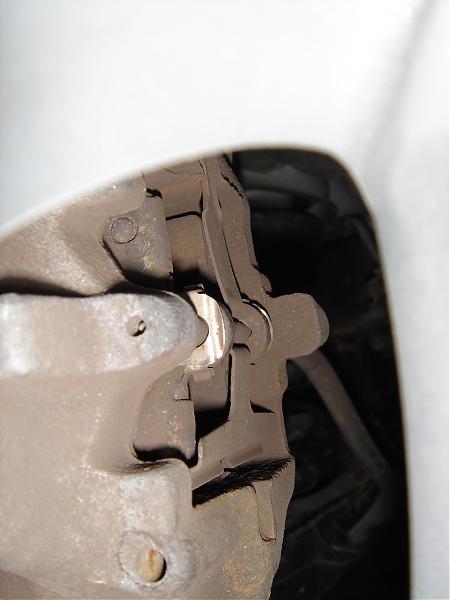

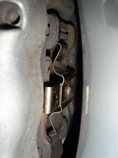

guys..took picture of passenger front and rear..this is what i see..so can you see if pads look worn or not from this photos..

Old Apr 1, 2007 | 01:21 PM
mleskovar's Avatar
Joined: Nov 2001
Posts: 5,851
Likes: 196
From: Huntington Beach, Ca.
'17 Jaguar XF

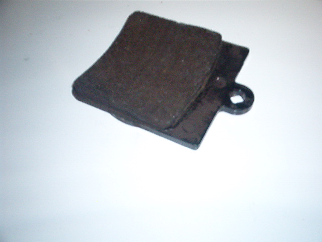

No. Here's a picture of a rear pad. The material facing up is what you are looking for.

Not from those pics, you need a picture straight from the top of the caliper looking down. You need to see the thickness of the pad material edge. A pad is made up of two pieces, the thick metal backing plate, about 1/8" thick metal. Attached to the face of the backing plate and touching the rotor is the pad material. You can see the outside pad with the wheel on but to see the inner pad you need to remove the wheel and look in the pad inspection hole which is on top of the caliper. Unless you are replacing the pad because you don't like the pad, ie. it gives off too much dust, then wait for the sensor to go off. No additional damage will be done to your rotor because you waited and even then so what, rotors are cheap and I usually replace them when I do pads. I just ordered rear rotors for my kid's SLK, made in Germany, $34 each, free shipping, no sales tax. It would cost me $15 each to get them turned and then wait an hour while they do it and they are still rusting and dirty. Not worth the hassle and my time.
