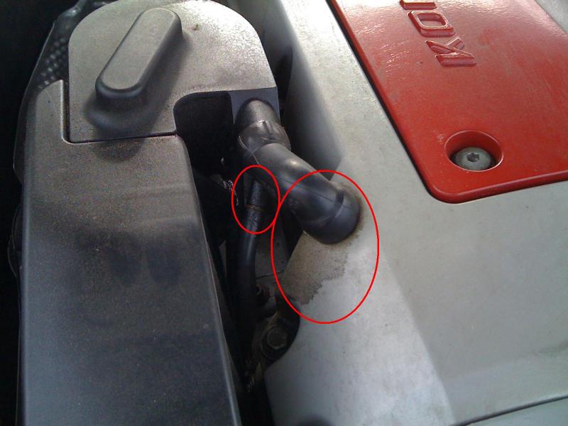

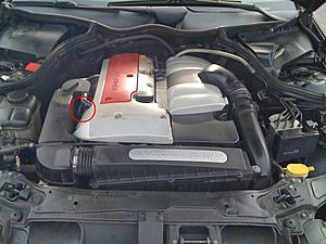

Hi all,
My car recently turned over 150000km. Opened up the hood today and saw some dried up stuff at the location where a pipe connects to the engine. Any idea what that pipe carries and should I be worried about this dried up leak?
Any advice/suggestions are welcome.
Thanks.
Look for the red circles in the pics.

i would say that you have a cracked pipe or fitting and just need to replace it.

Although, what does that pipe carry? Is it engine oil?

Oil fumes - it's a breather.

Huh? Lol.
Is it intended to be that way? Sorry Glyn...no idea what that means..

It's not very important - It's a captive crankcase & tappet cover breather that feeds into the oil catcher on the inlet. If it worries you just get a new rubber pipe.

Awesome....thanks!
Im going to clean up the mess and see how long it takes to happen again and then decide how quickly i should change it.
