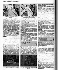

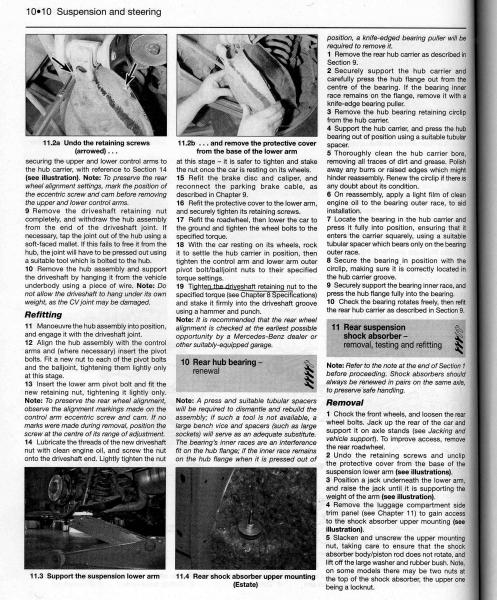

Hello Ole, In the absence of any other info ,I have attached a couple of pages from my 203 C Class 4 & 5 Cly Haynes manual. 2000- 2007.
It would be adviseable to also check from another source.
Good luck.
Carsy.

Thanks!
Just what i was looking for.
Best regards
Ole
