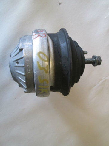

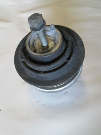

my mechanic told me that they are all the same, that the part number change with the different classes and years but its the same part. i ordered them used from a 2003 slk and i hope that will work without any problem on my 2005 c230k. here you han see the pictures and the description of the mounts i buyed, what do you guys think?
http://www.ebay.com/itm/121047222467...84.m1497.l2649
http://www.ebay.com/itm/110996818778...84.m1497.l2649
also the transmission mount
http://www.ebay.com/itm/300549163198...84.m1497.l2649
thanks

hey, just to make you guys know that almost all the engine mounts are the same, the part number change but is the same. i bought a pair of a 2003 slk used like ner engine mounts and intalled it on my c230 2005 and they worked PERFECT, now i feel my car way more softer and silent. like new

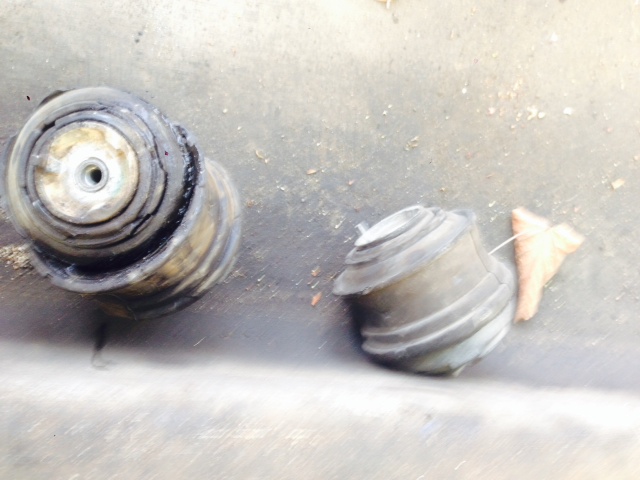

Old Jan 4, 2014 | 02:39 AM
pgg10's Avatar
Joined: Apr 2013
Posts: 16
From: Dominican Republic
Mercedes Benz C230 Kompressor 2005
pictures
here are pictures of the damaged mounts and the new ones that i bought on ebay
Attached Thumbnails ENGINE MOUNTS HELP-photo-3-2-.jpg   ENGINE MOUNTS HELP-screen-shot-2014-01-04-3.37.49-am.png   ENGINE MOUNTS HELP-screen-shot-2014-01-04-3.38.00-am.png
Old Jan 4, 2014 | 10:36 AM
Glyn M Ruck's Avatar
Super Moderator
Joined: Jun 2008
Posts: 19,942
Likes: 192
Ouch ~ those old ones were toast.
