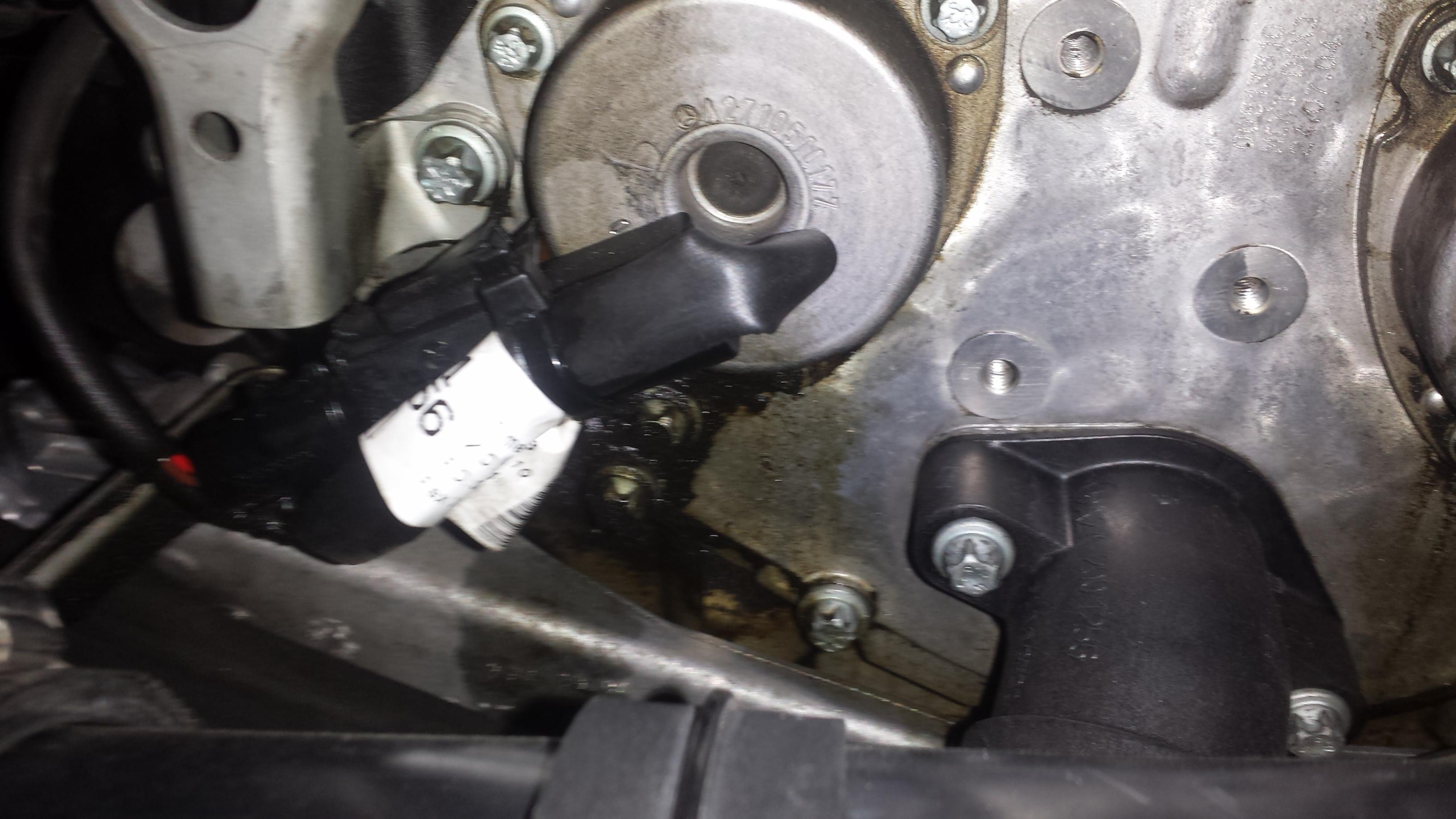

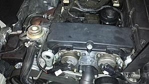

Second-In the top front of engine, under plastic cover, I'm getting another oil leak. I'm not sure what the area is called, so hopefully the pics will be sufficient...is therea gasket that can be replaced there?

These are Camshaft Adjuster Magnets on the front.
Is the oil leaking from under the housings or dripping from the wire connectors?
In the former case you can try to tighten the bolts and see if it stops leaking,
or buy new o-rings (#174 here: http://www.mbpartsworld.com/showAsse...rimLevel=20599)
If it's dripping from connectors, you are looking at replacing the magnets themselves.
Seems like you have pigtails fitted to the connectors, so the oil will not get into the engine wiring harness. (See this thread https://mbworld.org/forums/c-class-w...nsor-leak.html for what happens if the oil gets into harness)

It is leaking from connectors...So will have to replace the magnets...but,I still can't figure out where the main oil leak is from...over night, the puddle is about 10"in diameter...I can't believe it's coming from the magnets...
