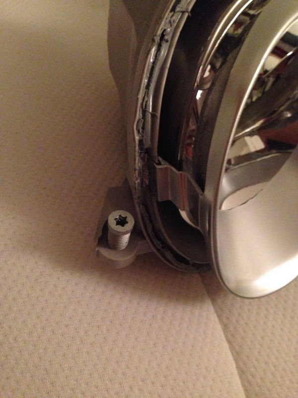

Can you show some pics ?
There are long grey adjusting screws to align the headlights to the car body , did you adjust those ?

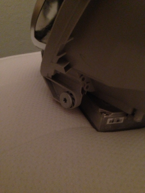

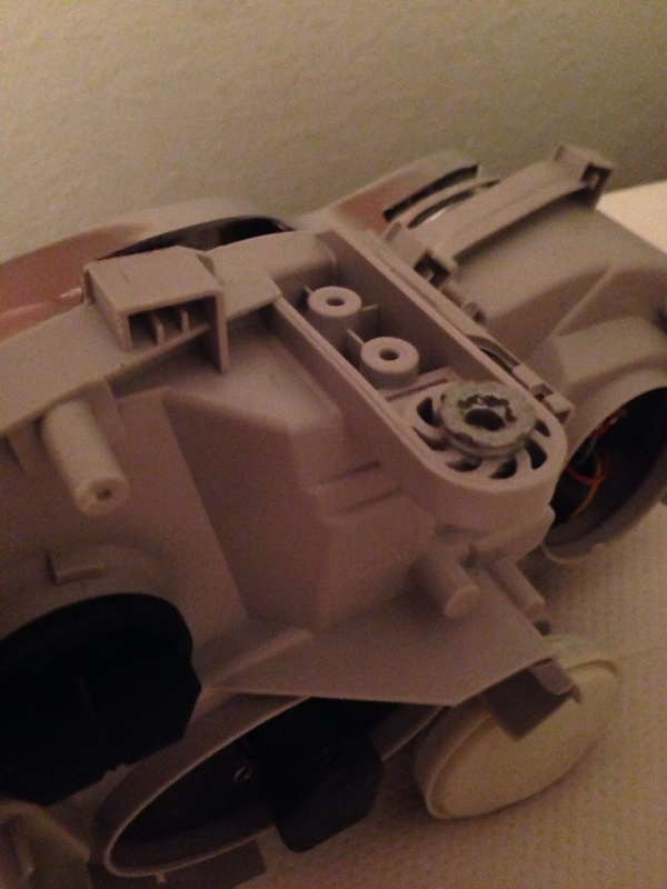

No probs, they are screws they are 3 screws I think that look exactly the same, and they are not the ones that adjust the headlight reflectors, If you still can't find them tell me I'll snap a quick pic for you !

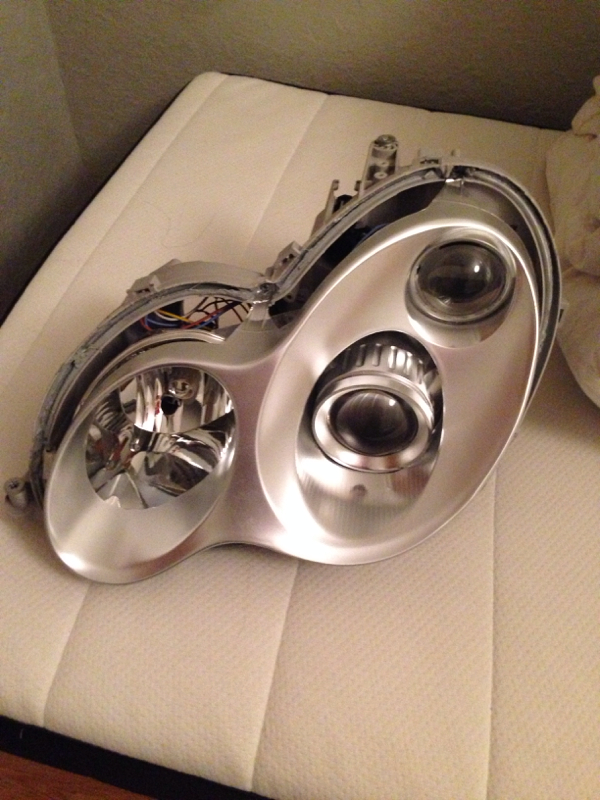

Ok sure i'll send you pics of it now, i bought the exact same headlight so it'll look the same for you, i'm modifying it with Morimoto FXR-3 projectors that's why it's opened.

Here are the photos attached, hope that clears it up for u !
