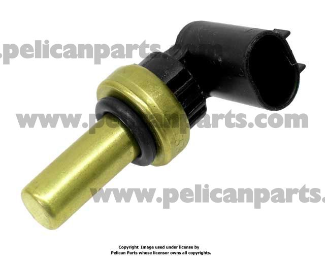

Talked to an indy mechanic who said you actually can change it w/o draining the coolant if you're fast enough and by using your finger as a stopper until the new piece is installed. What I'm not sure about is if there's a NEW O ring that I should have or just the piece below? A video shows there is an old O ring with it and not to reuse it. Do I have to drain coolant to replace int. coolant thermometer?-kfdupd8.jpg
