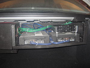

here is a example of what is did

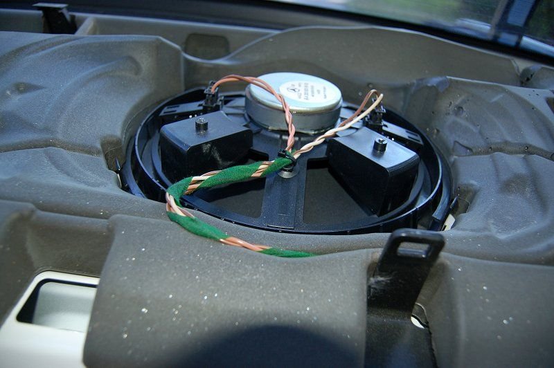

Your other option is to remove the factory fitted Sub from the parcel shelf. If not fitted then the blanker piece.

i removed the back seat from the car and cut out the ski sack area plastic and custom made the the grill that matched my interior color

Thanks a lot for the idea, I removed the factory sub and it sounds a bit better but not as good as it could. Cheers for the pics as we'll mate.

Thanks man. That looks sweet. Damn good idea too. Hoping to get round to trying at some point.

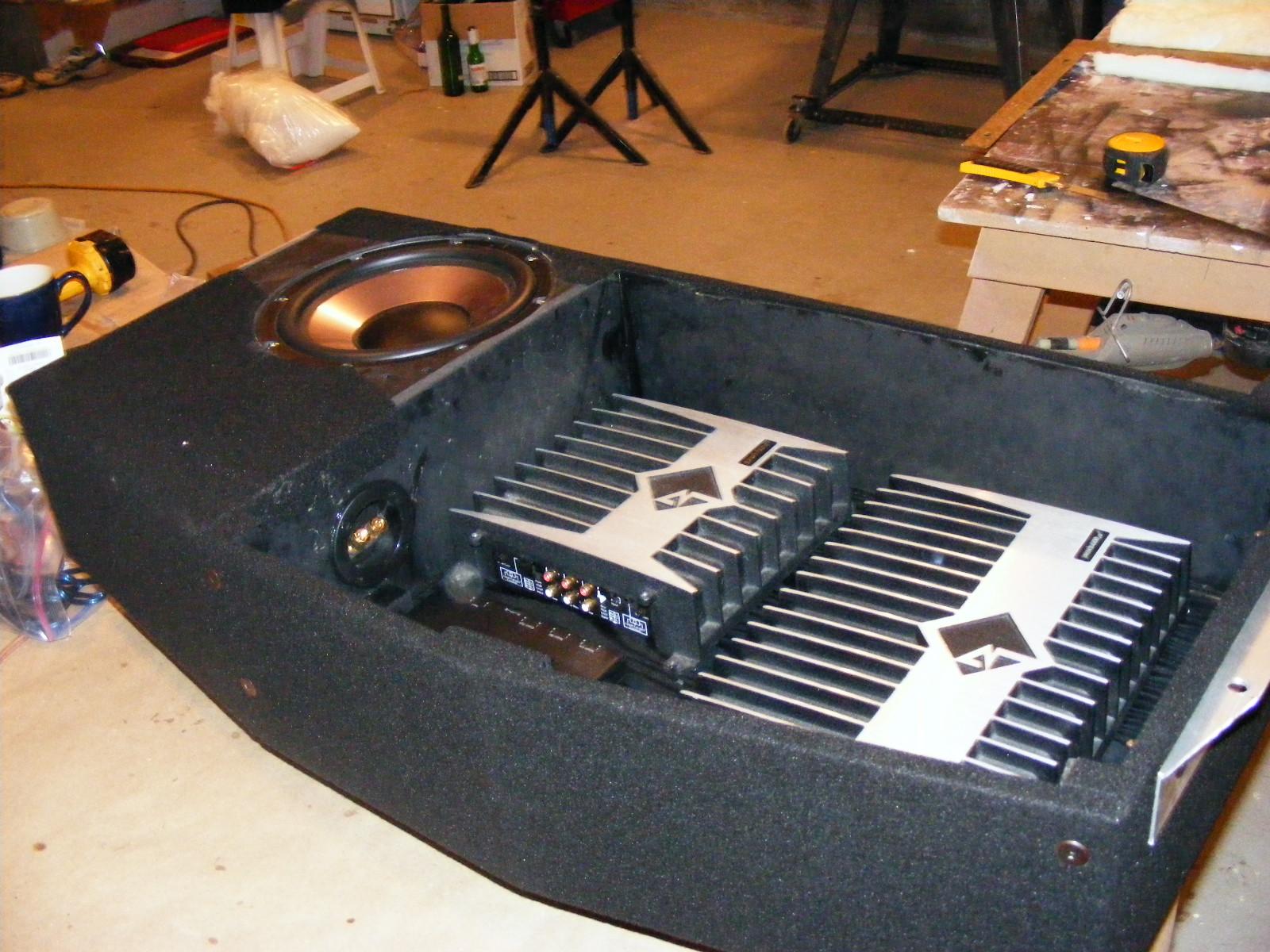

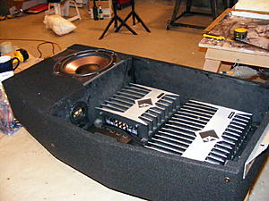

I removed the rear deck and cut out the foam covering the subwoofer openings.. added sound deadening.. made sure no rattles. and built and amp and subwoofer tray that fits directly under it. Well sealed between the sub and the deck..
Attached Thumbnails Subwoofer bass-c240-sub-amp-tray-.jpg   Subwoofer bass-subamp-tray-installed.jpg

D': its beautiful

Neat job! Very impressive!
