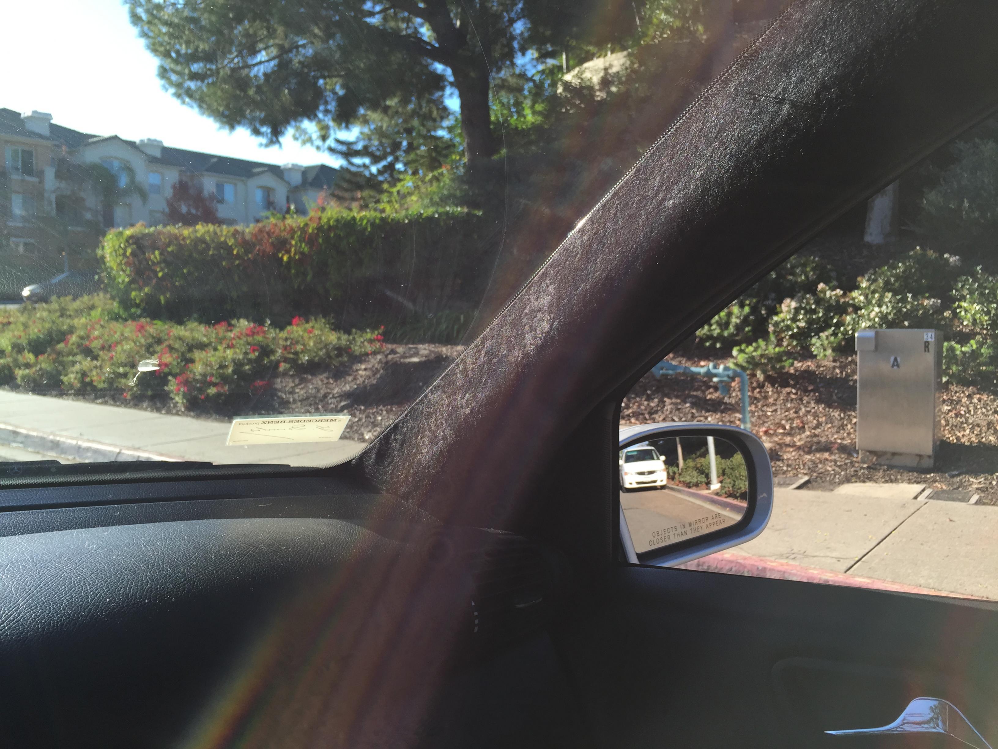

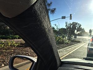

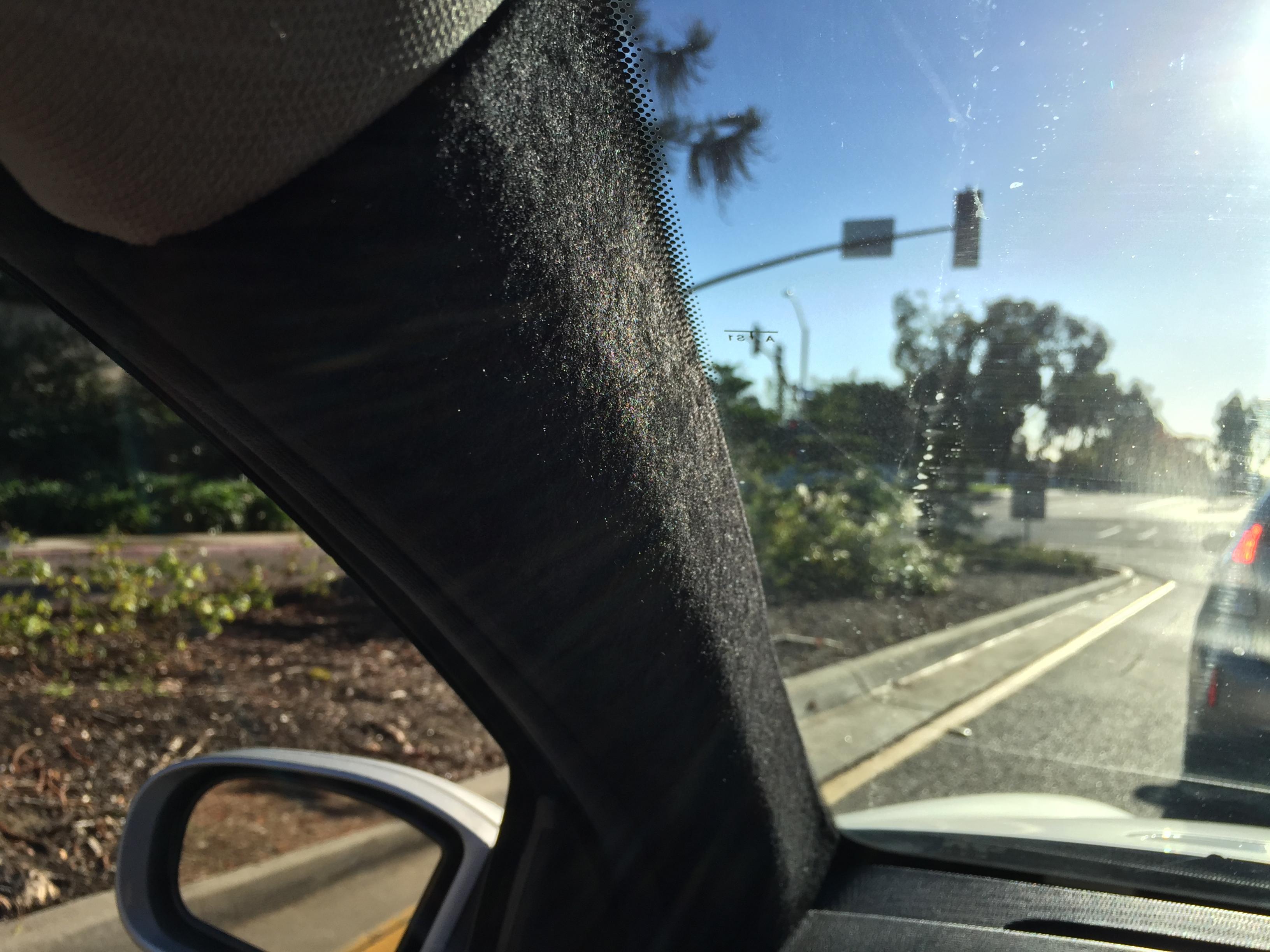

Changed the rippled gray fabric on my A pillars to black polyester suede.
Attached Thumbnails What did you do to your Benz today?-img_0083.jpg   What did you do to your Benz today?-img_0076.jpg

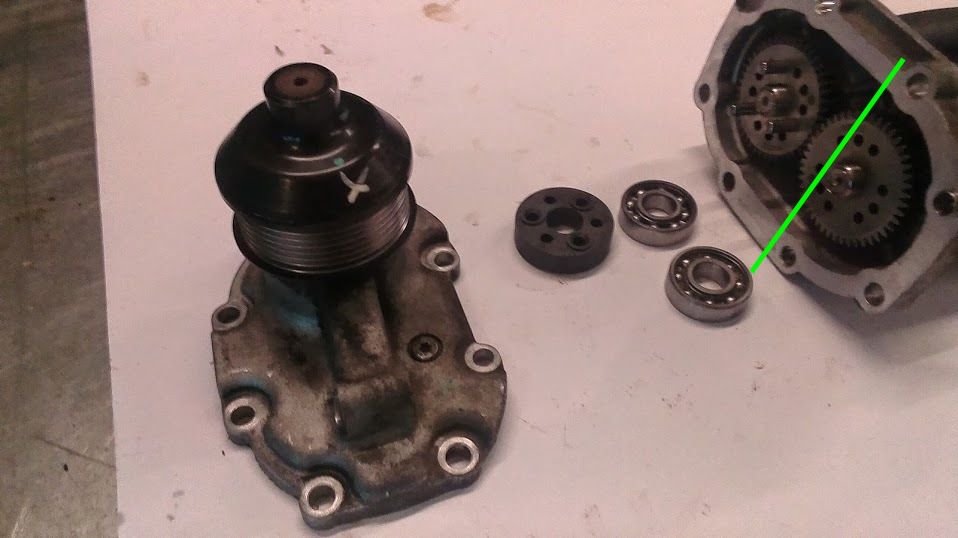

Also, fyi looking at the fill plug line on this pic I found on the internet,
based on the green line I drew, it looks like with 75ml filling to the fill plug level, the oil will cover most of the bottom gear, which I assume would be plenty to oil both gears as they turn. With 135ml of oil I'd think your oil level would be close to halfway up the top gear. I can see if the SC was laying down as in this photo, maybe the fill plug would sit at about 135ml .... but with it in a vertical position the only way to get more oil in there is to shoot it in fast and try to plug that hole as quickly as possible.
Maybe they recommend a "full fill" because they know it leaks out over time, and they want it to last a while before it's all gone ... ?
I think halfway up the bottom gear is still pretty good though. Maybe I'll d another drain-and-fill in a year and see how much has leaked out.
