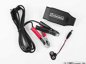

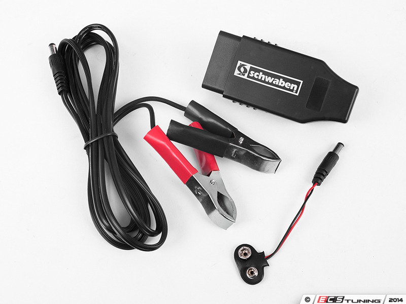

What about if you had something like this hooked up? This should save all the settings so nothing should get reprogrammed.
http://www.ecstuning.com/Mercedes_Be...ery/ES2748866/
Attached Thumbnails Battery change damaged the elecrical system?-614293_x800.jpg
