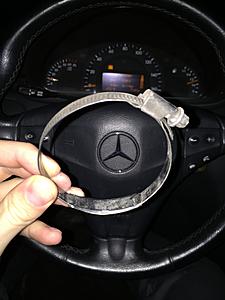

I did get a Check Engine Light last night after this post and it read as code p0237 which is a supercharged bypass issue. Upon further inspection I noticed that there was a huge clamp at the bottom of my engine bay. I looked at the supercharger and noticed that the large hose seems to be somewhat pushed off the supercharge exposing another red entrance hose. I am thinking that this clamp may have fell off after boosting or was not put on properly when I had my belts changed at the dealership 3 months ago. Does that sound somewhat possible?

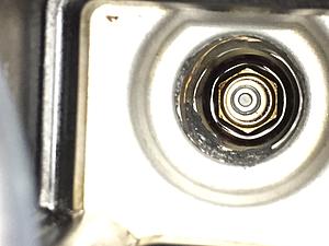

This is a photo of the 2nd spark plug after I removed the coil pack. It did have some oil present but I used a vacuum to clean it up along with compressed air. I'm not sure if it's noticeable in the picture but that silicone tack on the walls of the spark plug positions is present in every spark plug entrance. I've never changed the plugs but the dealer changed them under warranty 1 month after I bought my car. Is that normal?

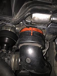

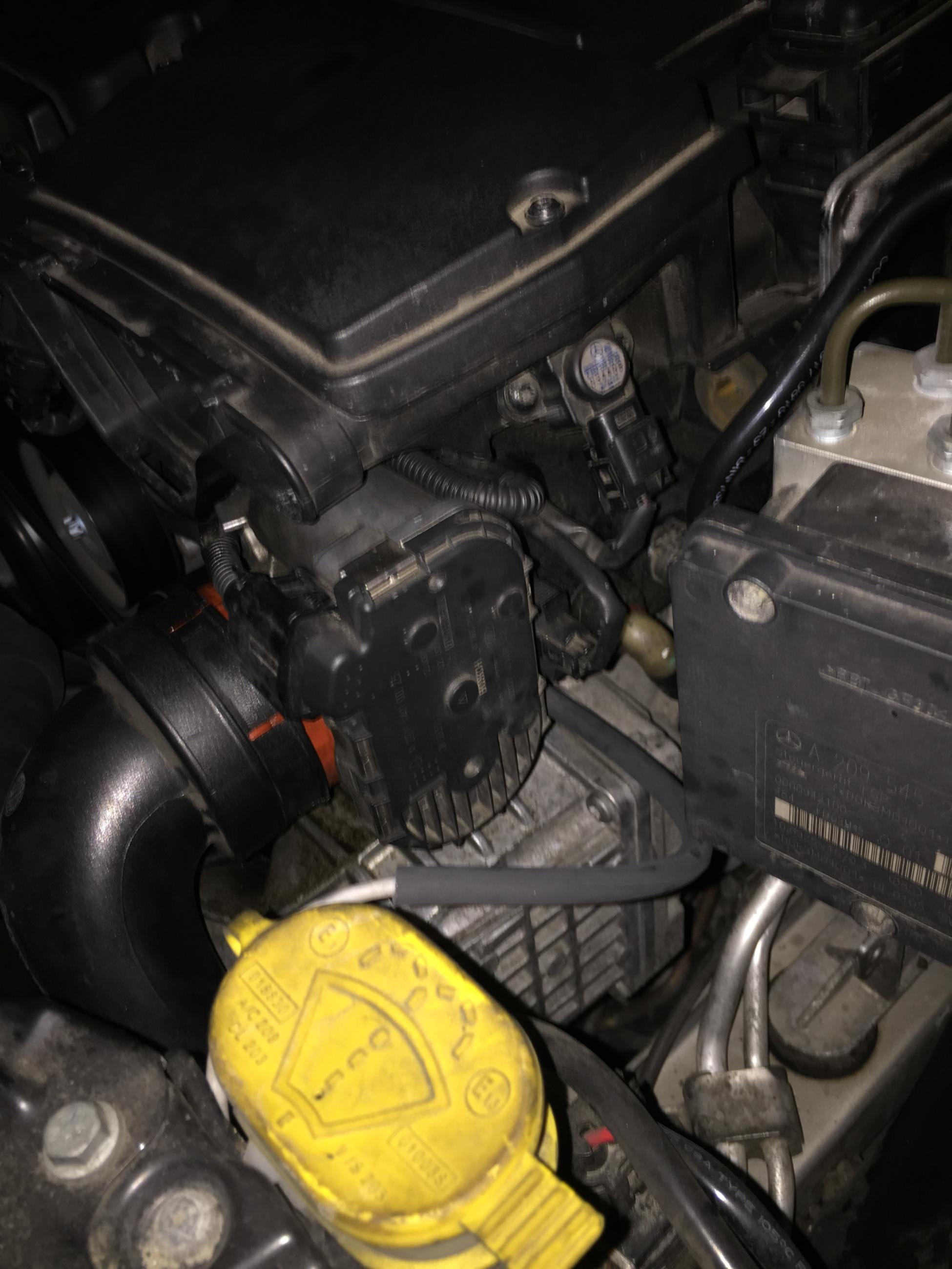

Here are some pictures of the hose that is disconnected and the clamp that I found at the bottom of my engine.

Slide the black pipe install the clamp and slide the black pipe on making sure the red exposed thing is not visible. Look at the small slit on the black hose and the red thing, they both have a slit. those slits need to match up and the black pipe needs to be pushed all the way up, then tighten the clamp. Hopefully this will fix the issues that you are having.

Looks suspicious. Looks like the dealership did that on purpose to sell you a new supercharger?
That pipe does not need to be disconnected at all when changing the belt.

Reattached the hose and applied the clamp. Everything works great now and I cleared the CEL. It has yet to come back on so I hope that it stays that way. One question though... When I was fitting that hose back into the opening there was lots of oil on the underside of the opening.. I cleaned it up and I will check again to see if it comes back but I'm hoping I don't have leaky cams or something worse. I do remember that I got an oil change from the dealer in January and they spilled oil on the engine and did not even clean it up. Might have got there from that time.

That oil is normal...everyone has it.
