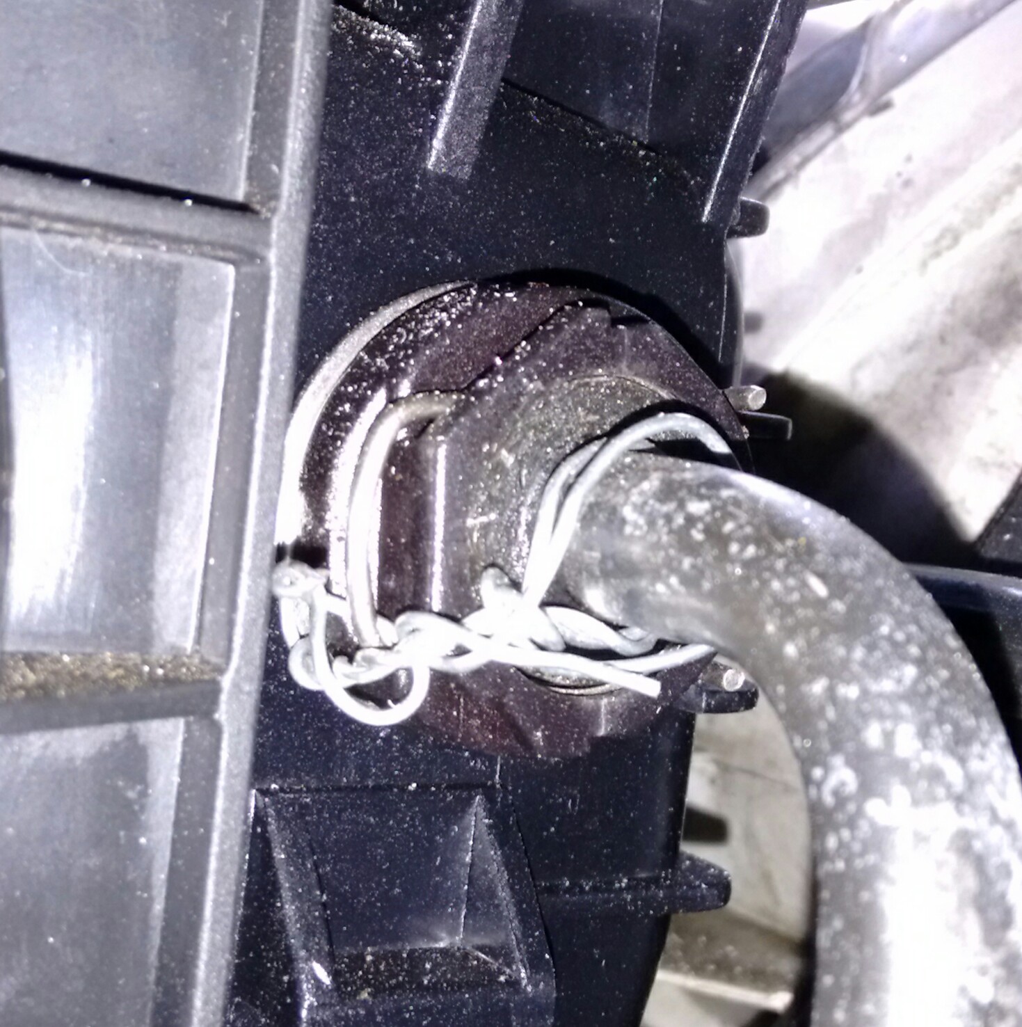

I couldn't get a clear shot of the lower line so this is the upper. They're both identical. You'll have to do the lower line from below the car. Take a peace of wire and tightly wrap it around the large diameter port (behind the clip) on the radiator side, take another piece of wire and tightly wrap it around the ATF pipe, then twist the 2 wires together. Its not pretty and its a PITA to work on your back with needle nose pliars but it works. My car also got a replacement radiator from the previous owner so thats where the fault lies I guess. On my car the upper line was popping out so I would do both the upper and lower at the same time.
Thanks for the image. It still looks like there would be a possibility of it coming loose. Just not off...
Yes but it won't pop out completely and make an oily mess of the engine bay. Worst care scenario it'll be a slow drip. The O ring on the hard line is pretty far in there so even if it moves out a little bit it won't leak. This connector is a really stupid design. On older MBs like the W124, W210 the hard line has a giant nut around it that screws onto the radiator. MB got cheap here.
