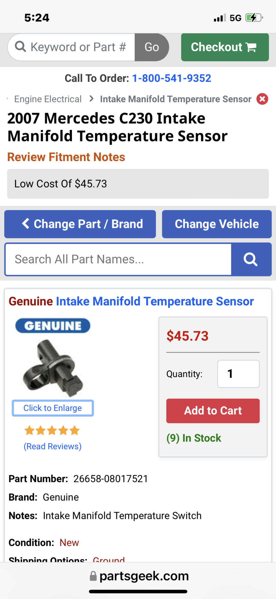

Just did mine
Just did mine last week I watched a you tube video along the way pausing when necessary I got the metal repair kit of eBay my middle one was not connected anyway once out I cleaned it all up a replaced the metal part put a lil grease into what they snap into
it’s not too bad gives you a chance to clean fuel injection gaskets hardest part is gasket staying still when dropping back in
double check everything once you’re done I missed plugging in a sensor that gave me 10 different codes and ran like **** but once I found it , it was the intake manifold temperature sensor in back once I fixed that she ran perfect
