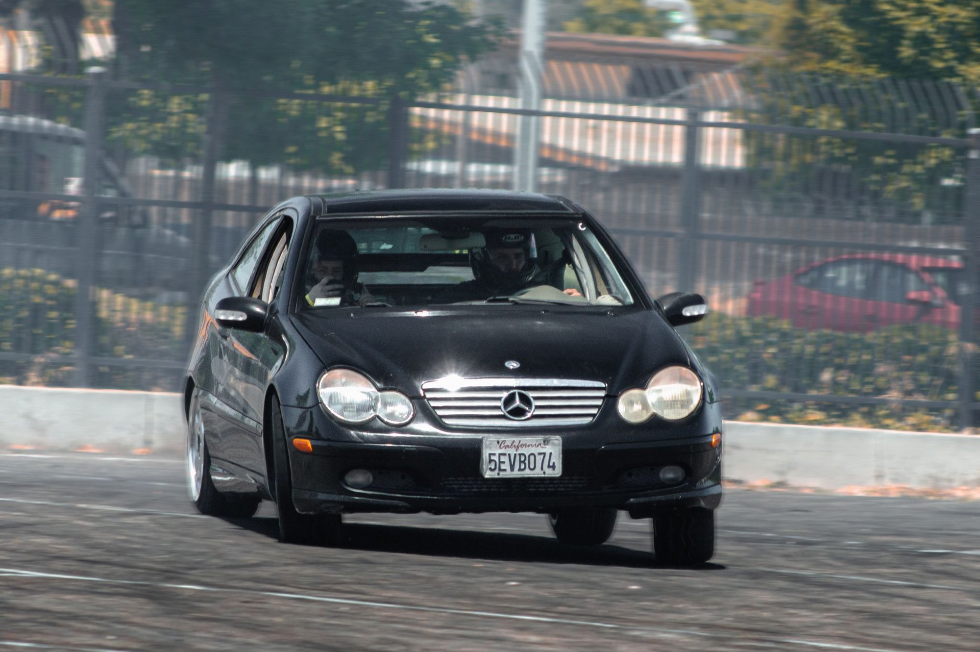

This past Sunday I took the car out for its first event! She did really well... had a downfall and broke I believe the pin that hold the shifter to the transmission.. so besides my gear shift being a wet noodle I was able to drift all day!
Car had a bunch of power I put the overdrive pulley from eBay on and make about 10lbs of boost now, I deleted the ac and ac condenser and added a bigger power steering cooler also the 3.67 gears make this vehicle very torquey.. so I gotta fix the shifter and figure out how to get some more camber outta the front suspension to help with the contact patch at full lock!

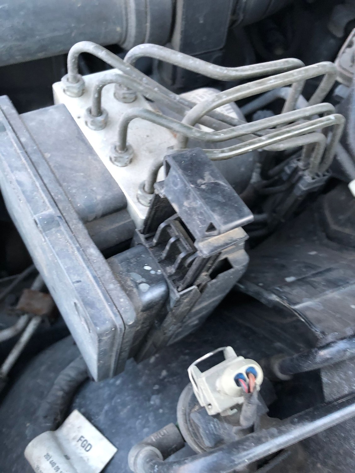

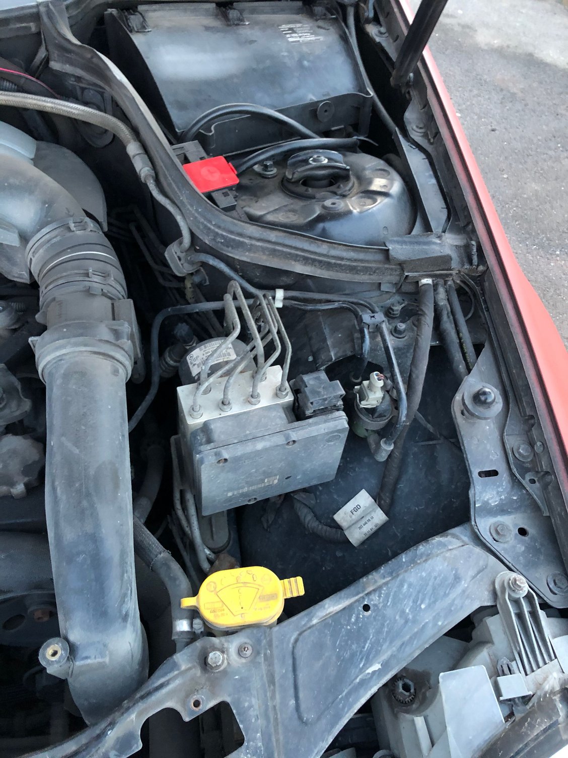

I am only new and primitive to drifting and run a W203 coupe with a welded diff, and have had no major problems. I unplug the multi pin plug on the back of the ABS unit in the engine bay and it disables the sensors and ABS, the dash lights up like a Christmas tree, but resets when plugged back in. I also have no engine power loss or brake fade or wear issues.

hey bro, I am new too, I come from s chassis scene. anyways want to get back to sliding and was looking at the r170. what you do with the abs pin. can that also be done to the r170? I want to set up the car for drifting. thanks!

I would imagine the R170 will be same set up - on the back of the ABS/ESP unit in the engine bay is a multi pin plug. I just pull the release slide to allow for the plug to come away from the unit. As per these two pics.

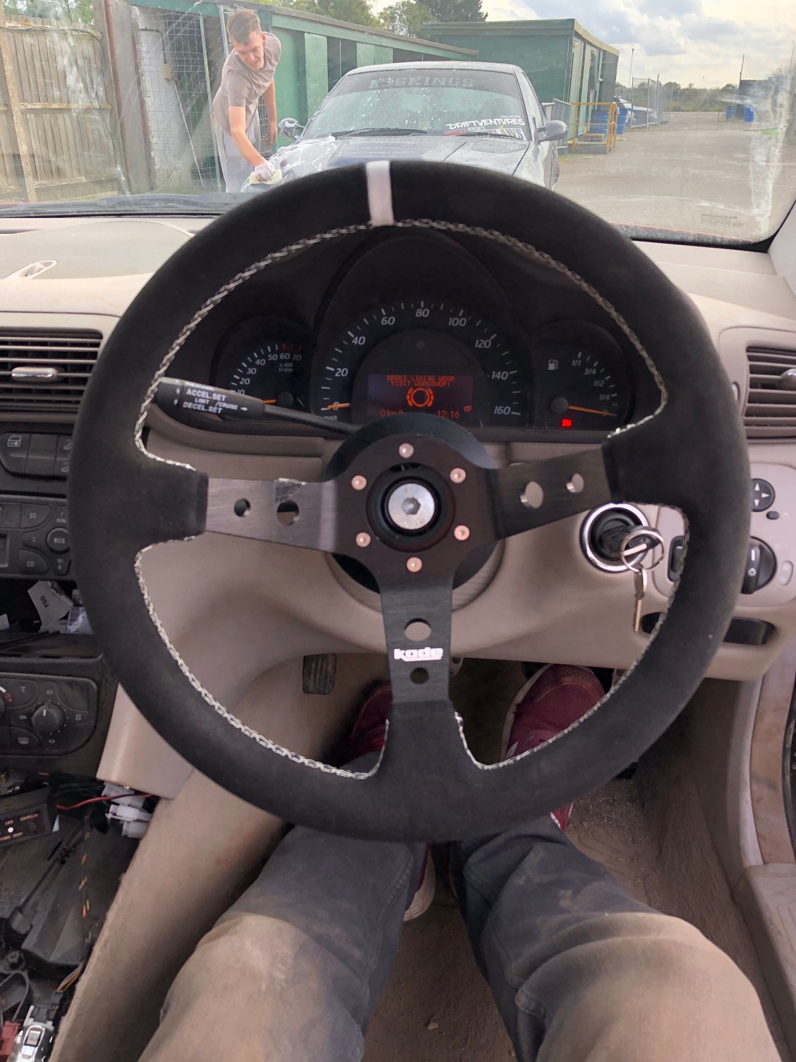

Hi, have any one of you changed the steering wheel to momo or something like that? I want to change the steering wheel, but I can't find the steering wheel hub for w203.

I used an E36 steering hub. As per below picture attachment. You lose the dash control buttons. So to know my engine temp for example I have a OBD2 adaptor and a digital dash on my phone.

Thanks for your quick reply, does e36 have the same amount of teeth and the same diameter? But I am planning to leave the turn light signal switch because I am planning to keep my cl203 street legal.

Hi
yes it does. It’s a perfect fit. Same number of spline and diameter.

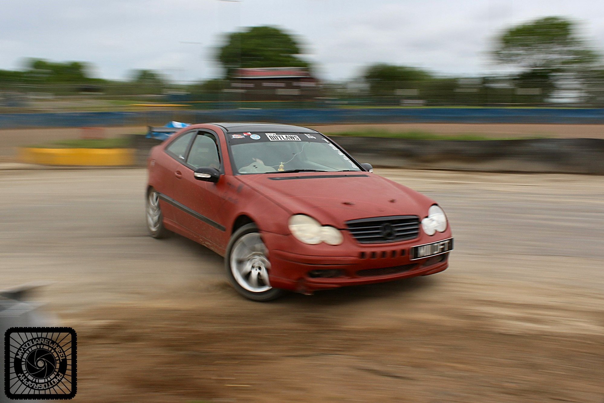

Door on door action with a E36. The car was suffering today with a missing bolt in the rear ARB and bushes finally failing in the hubs on the lower rear arms.
