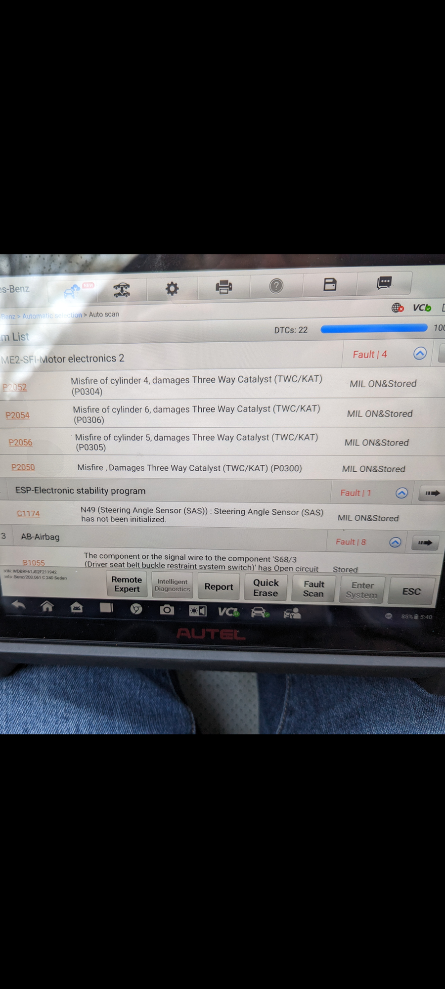

Hello,
I have a 2002 C240 that recently started throwing the check engine light. When I gas it, it flashes and loses power.
One time, I pulled over into a neighborhood to recrank it and as I was making the U-turn, everything went out (power steering, acceleration, engine) and all of the lights on my dash flashed. I cannot drive it over ~40 mph or it gets weaker and weaker until it fails altogether.
I hooked it up to a diagnostic tool and saw four cylinders were misfiring (1,4,5,6). I replaced all 12 spark plugs but they were still misfiring. I replaced all 6 ignition coils and tubes and it's still doing the same thing. My brother suggests vacuum tubes, my dad suggests catalytic converter, but I don't want to continue throwing parts at it until I'm sure what it is. It's also got a brand new SAM and ECM from past repairs.
There is a small rattle that started underneath the driver side about two months ago, but I assumed it was an exhaust clip that broke and it was just bouncing around a bit. It does it sparingly and I'm not sure if it's related or not, but maybe it finally knocked something it shouldn't have?
I have attached the error codes from the other day.
Additionally, if you know how to fix the airbag issue, information on that would be much appreciated.
Can provide further details as needed.
