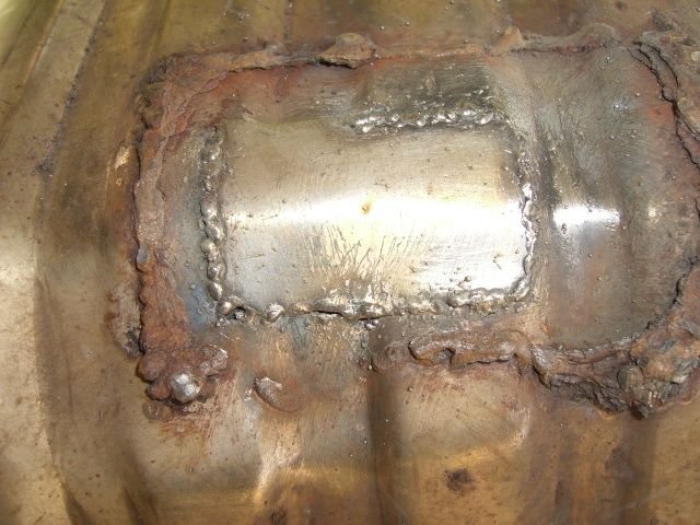

The bottom half is ca. 1 mm stainless steel, maybe 1.2 mm, the upper half is two 0.8 or thinner stainless sheet metals in a wave like bend style which like to crack. I tried to replace the upper half with a thicker sheet but my welding skills are too bad to do this. So I weld the at least 20 cracks together from time to time.
I'm really curious if you can do it and how.

crack
crack
patch
patch
patch2
patch2
Do you have some pictures of the welded muffler? (I used stainless flux core wire)

And you don't have cracks in the upper half?
red circle crack, yellow near rusted through damage
cracks
cracks

not a single crack on either of the mufflers i have, maybe I got lucky with the alloy that happened to be used for mine or something.
