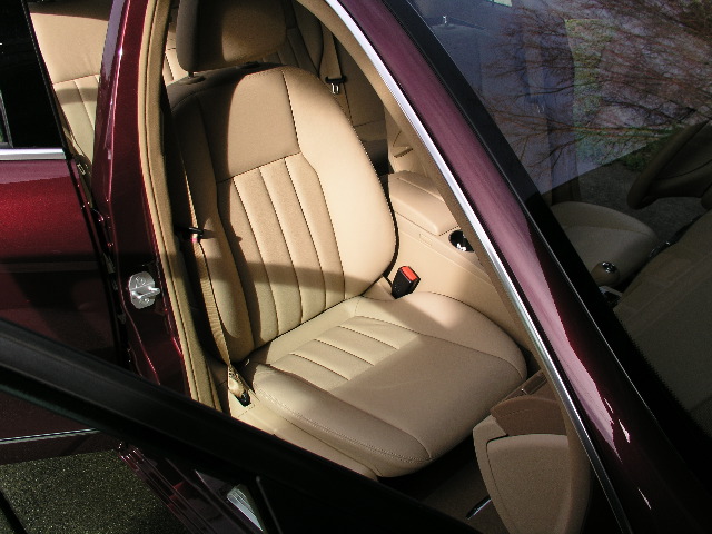

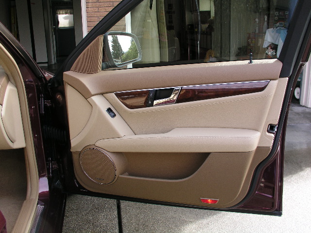

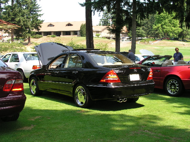

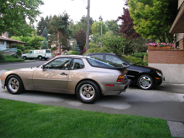

Clean. Must be clean.....
Originally Posted by JimPap
You guys love your engine compartment a little too much.
That's right. Some of my best dreams are about my engine compartment.
Aside from that, my mother always reminded me to take care of my toys.

I like the gardens.The Porsche looks OK too !!
