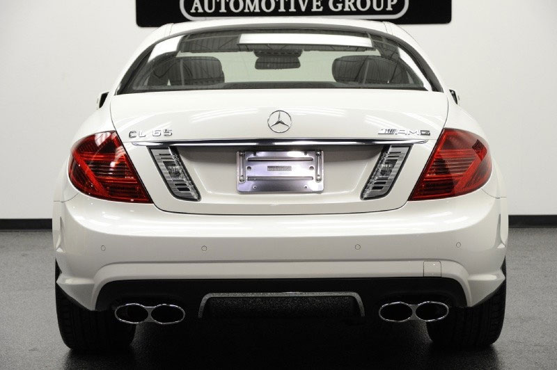

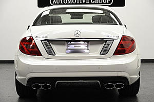

Inspired by this? Picture from an auction on eBay.

they are not direct replacement tips. They will not fit without modifying the mufflers. If you look the Y is in the middle, our need a straight out with an add on to the inside. These would work w magnaflow setup or something like that. The only bolt/weld on tips are from piecha designs but are 450 euro comes from europe

It is going to take some work to make them fit. A slight bend will be needed to bring them into the center of the diffuser hole.

I was at the exhaust shop today for 3 hours getting these installed along with an x-pipe. The shop did an outstanding job and the tips are on the car but it was a pain. They had to cut my mufflers out and add a piece of pipe before them in the back to give them more angle. This allowed them to hook the tips up so they look right. The finished product looks outstanding but I got lucky and found a really good shop that could make them work.
