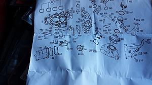

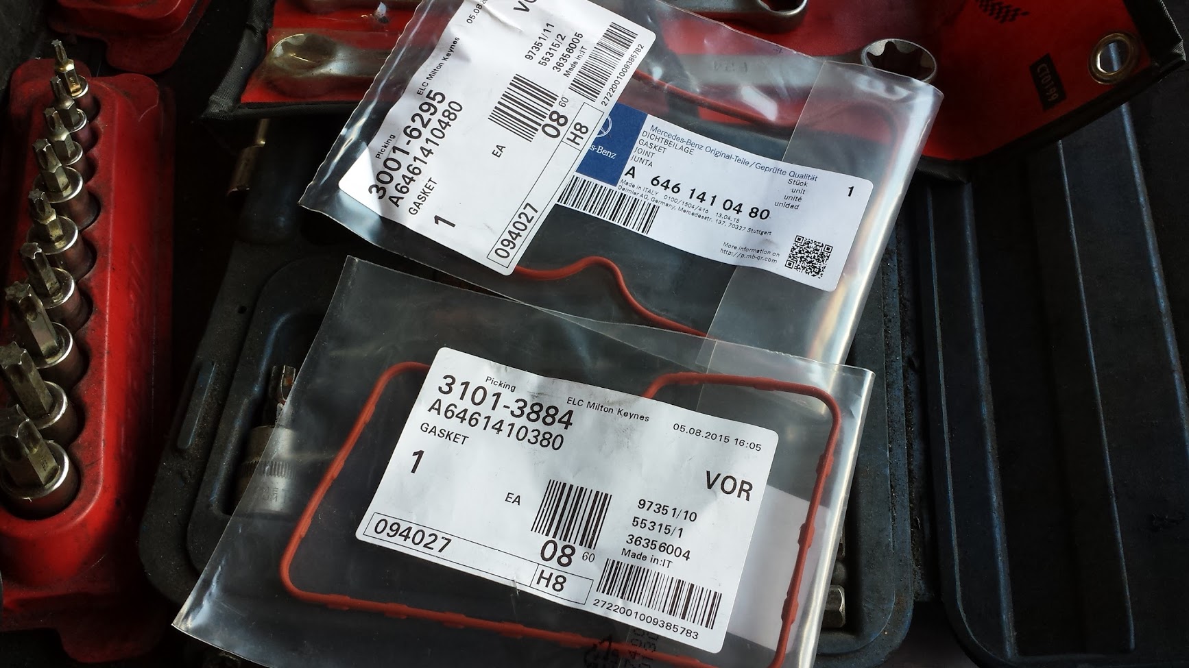

Solved - C220 CDI W204 2008 - EGR valve and cooler - coolant leak
Gasket changed today part 144 /142 in attached. Did it myself. The coolant had to be drained first. A bit tight and fidley job but happy with outcome. Used OE Merc parts and Merc blue coolant.
1.5 hrs it took me.
Thank you all for your support. Thanks @carsy

2X gaskets were £14.53. 5L blue merc coolant was 29.30£ (all including VAT)
