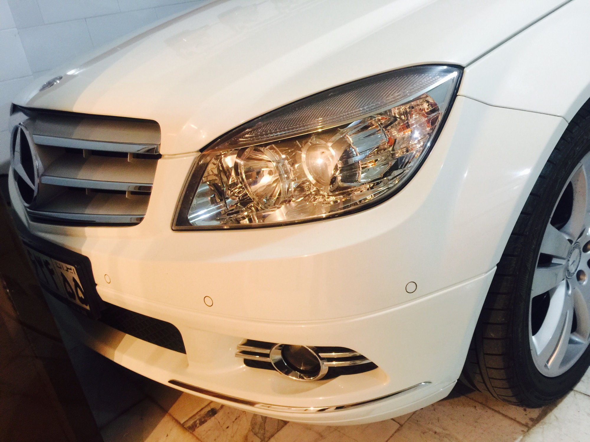

i bought mb c200k w204 2009
first problem
but it doesn't have xenon lights , the headlights are halogen 12v 55 w
before it all of my old cars had hid xenon and i cant driving whitout hid xenon lights because i will driving a long dark street every night !!!
we dont have mercedes benz agency here but one of my friends warned me if i change the halogen bulb whit xenon then my bulb house will be melted !! and he said to me He had already seen similar examples!!!!!
i wanna ask you is it right or not ?!?!?
what can i do ?!?!?
thanks alote

Get some quality HID kits like from the retrofitsource. You'll have proper power output and won't risk burning the projector housing or any of the electrical wiring. Their kits are a bit more than other sellers on ebay but TRS has great customer service along with their warranty and they will walk you through the purchase. I've bought many ballasts and HID kits from them for previous work and retrofits.

but i want xenon for headlight and i afraid of it the xenon bulb will be very heater that halogen bulb and melt housing bulb lenz or other part of it

Yeah the xenon and HID kit are the same. As long as you get the 35W kit then you will be okay. If you get a 55W kit then you will produce more heat than the regular halogen bulb and risk ruining your headlights.

Hi wattage Halogen bulbs do risk melting your housing but that also depends on the brand. Piaa, Osram, Phillips, the brand name bulb companies for the most part will not melt your housing. However if you want HID's then like Sagar526 mentioned, get a set of quality pnp HID kit from The Retrofit Source or AZNOptics, they both sell Morimoto brand HID's which are very good quality, I've been using them for many different cars and have them installed in my lowbeams and fogs now. As you have a 2009 model you should have the halogen projector headlights which will help reduce the glare from the HID lights, but you will still need to aim the lights after the HID install.

35wat hid xenon kit will be enough for me
i dont want replace in projectors
i need xenon for low beam only
you mean only high quality hid kits should be installed ?!
here i cant find original kits and only china build xenon kits are available here
and i cant acces to ebay or similar sites ...
if only way is originial and high quality hid kits i will transfer to europe for a few days !!!!

This is the kit we'd recommend. 35w so won't have melting issues. Morimoto XB35 are high quality kits.
http://www.aznoptics.com/index.php?main_page=product_info&cPath=2_8&product s_id=65
If your country has any sort of blocking and does not permit purchasing, send us a message and we'll find an alternative method of payment that works

Those morimoto kits are really good. You won't have any issues with the projector housing burning.

no i dont want it for projectors
i want hid xenon for low beam bulb

The projector is what the bulb goes inside of. So that glass piece you see is the lens and the whole thing is called a projector. You insert your new HID bulb into there and take the old bulb out for your new setup.
