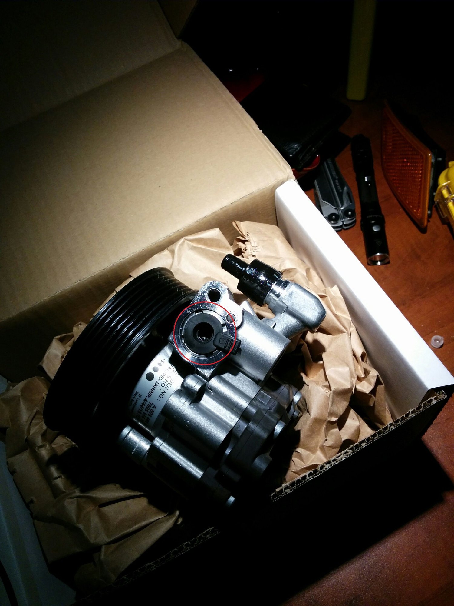

Thought I'd update this post with the result. The leak was cause not by the seal labelled #275 in the diagram, but the internal seal to that fitting circled on the pump in the diagram. I'm not sure the reason for failure. I've replaced the pump, filled and bled the whole steering system and now have no leaks or other issues.
Here's the failure of the seal. The actual pressure line fitting o-ring was intact, this was the one causing the leak
This is where this fitting screws into the pump. there is a protective rubber cap on it in this image (new pumps ship filled with fluid)
