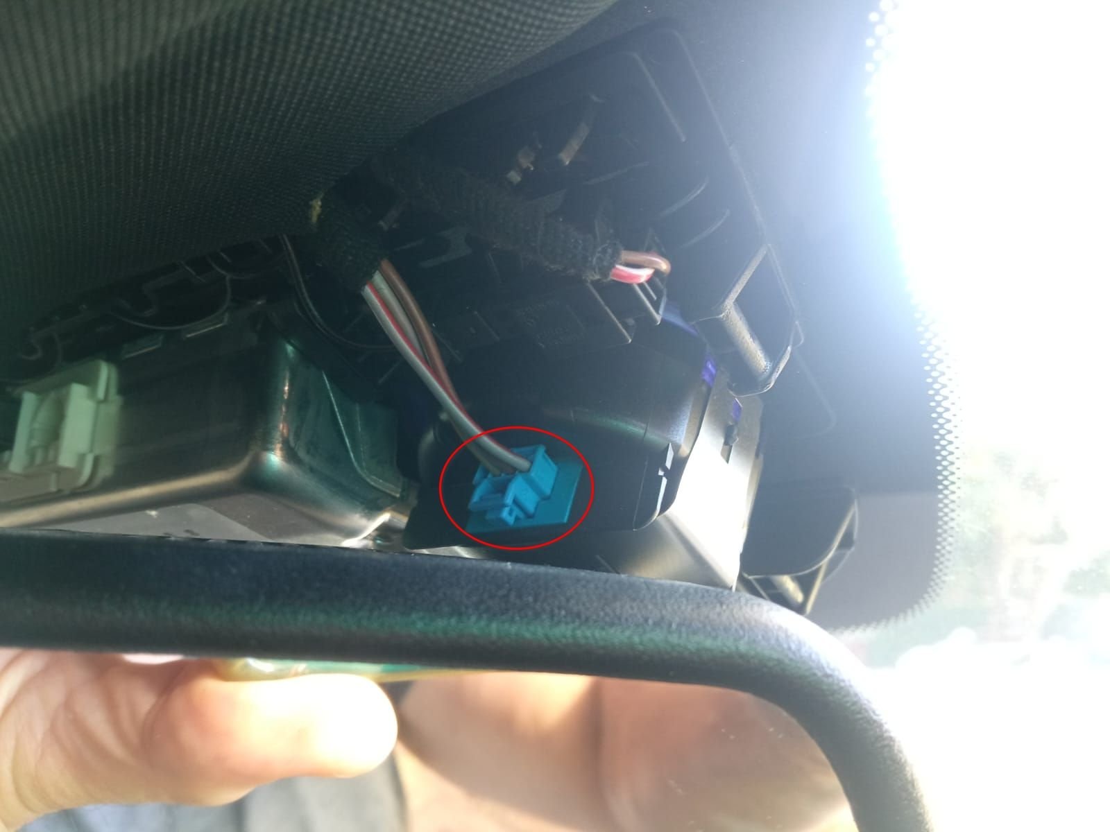

Attempting to install a dashcam and was wondering if i can cut a USB cable and connect it to the rain sensor plug to draw power? If so, which cable should connect to where? Can i safely draw power from the rain sensor (please see pics below)
Thanks!
https://ibb.co/ifz84v
https://ibb.co/bDdPcF
If that can't be done, I'll have to run the USB cable all the way to the cigarette lighter which won't be really practical.

That's exactly what I did the 1st time. Worked flawlessly....UNTIL I had my windshield replaced, and the installer (trying to be nice) attempted to reinstall the wire and blew a fuse, causing the AC to go bonkers. After getting it repaired (found blown fuse) I tapped into the overhead console instead (more room to work, plus I was a little gun shy touching the rain sensor again).

Good to know thanks , so which wire should connect to where based on the pic? My guess will be the red from the USB to the red from the rain absorption and the black from the USB to the brown from the sensor, is that correct?

I don't have a 12v outlet in the glove box so was wondering which wires i should connect to from the rain sensor or would it be easier/faster to use a connection from the dome light?

If you use any of the systems up in the top of the windshield , you run the risk of blowing an output transistor in the processor. Even the lights are controlled through outputs in the processor not by switches to ground as in the old car systems. This means that the switches are very low power processor inputs so the wires can be small. You must have a cigarette lighter somewhere up front. Run the power from there.

Your USB powered dash cam requires 5v at 1-2A. The power supplied to the rain/light sensor is 12v switched and amperage supply capability unknown . If you connect it directly you will fry your cam and maybe the car's control unit .You will need something like a 5v buck regulator module, rated to supply at least as much current as your webcam draws. There are plug-and-play commercial units available from several sources for exactly this purpose, so it can be done safely. On my car, in the photo below, the rightmost grey/red wire is +12v switched and the center brown wire is common negative ground.
