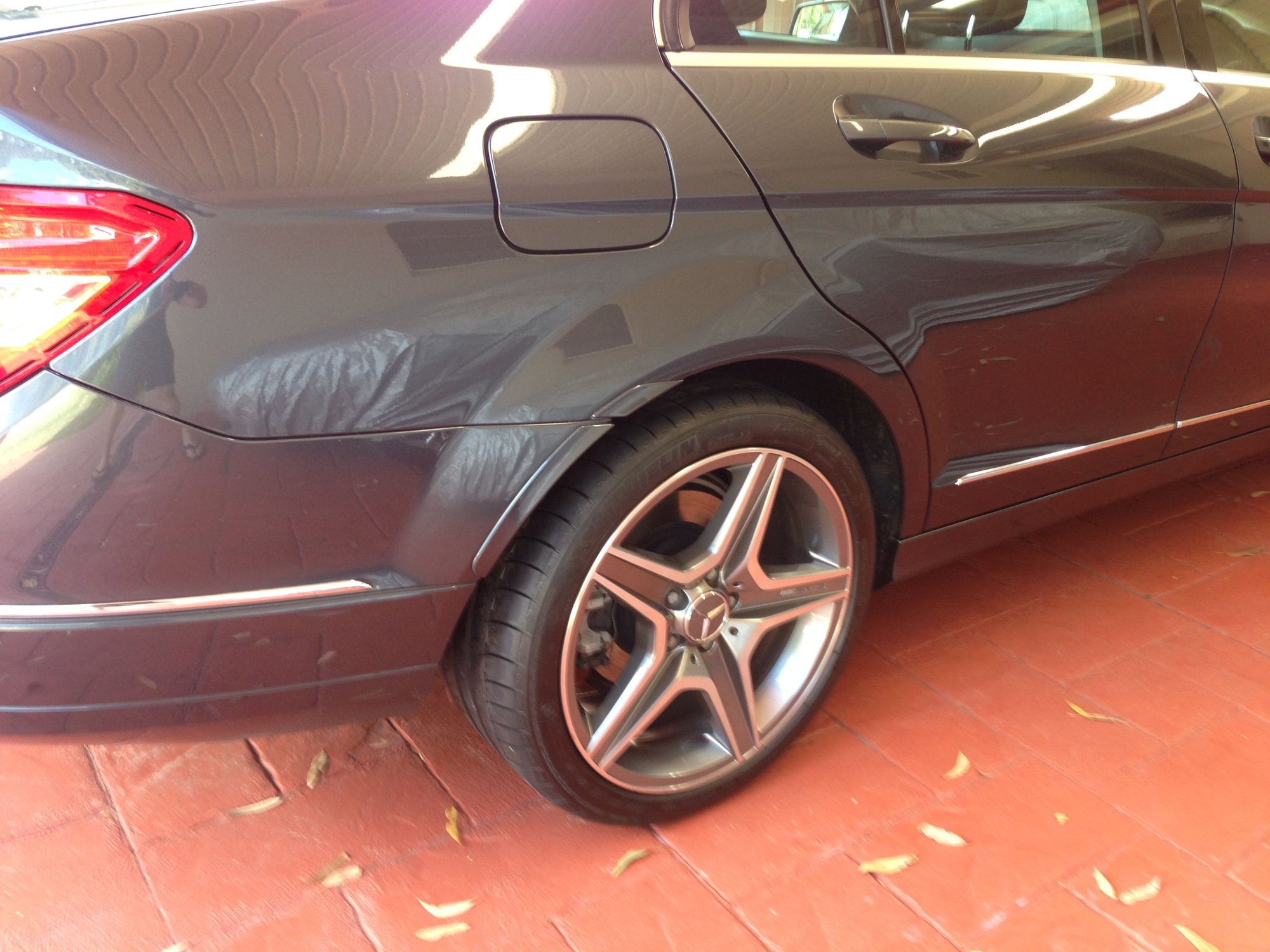

I just fitted the C63 AMG 18" rims and tyres on my 2011 C250 and they fit perfectly without any issues with the wider tyres profile. 255 rear and 235 front.
I have a mate with a C300 and he's running 265 on the rear and 235 on the front without problems either.
They would look awesome on your car.
Thanks very much for your info and pictures, greatly appreciated.
Looks to me that under full load, occupied with 4 passengers and possibly luggage that your C63 Wheels would be rubbing!!!???
That would most likely also be the case for your mate's car with the tire sizes you have provided.
I think I will stick with the original OEM spec.:
18x8, 225/40 18, ET50 in the FRONT
18x8.5, 255/35 18, ET54 in the REAR

There was no rubbing with 4 passengers including the mother in law lol 😂
