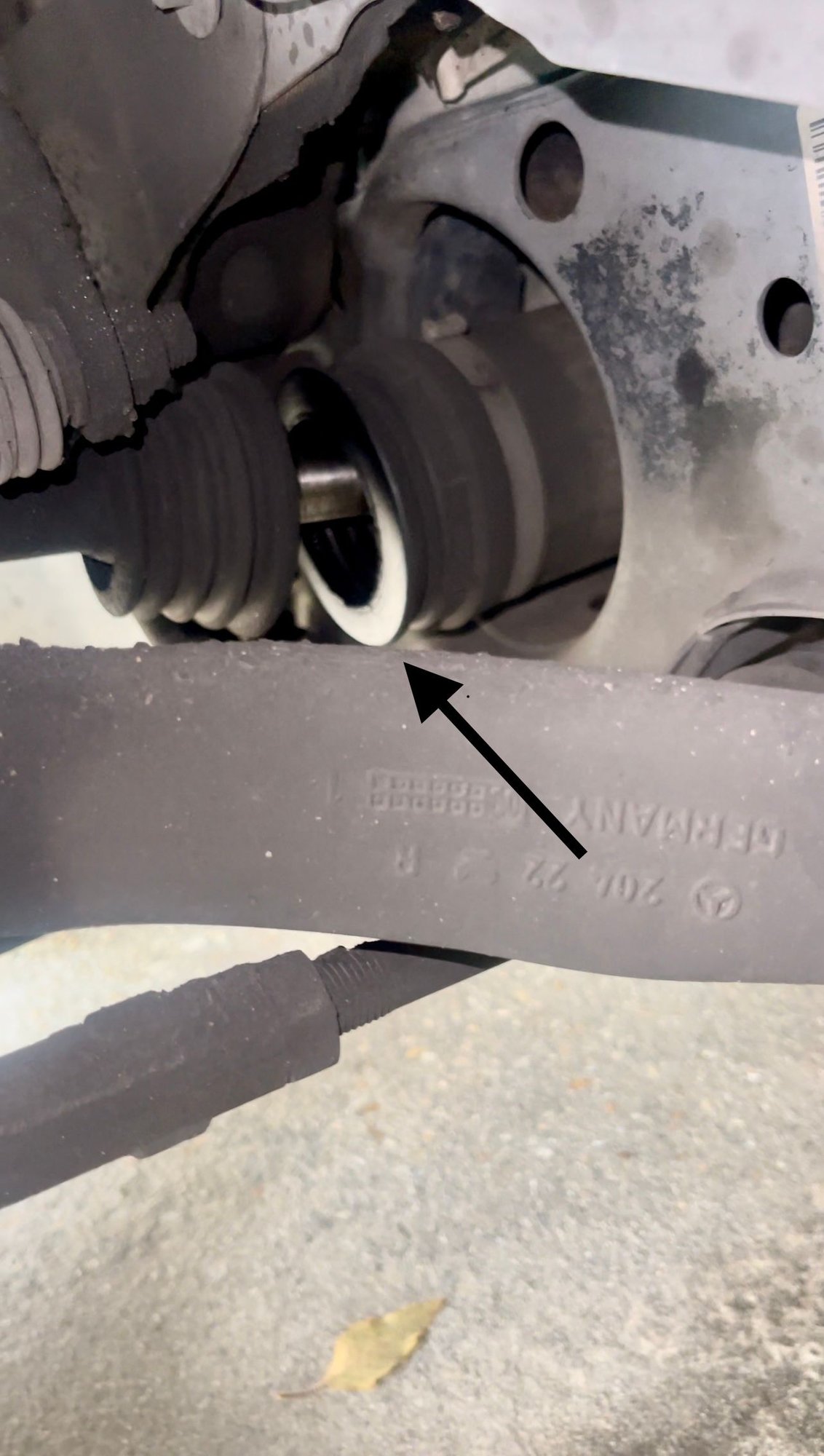

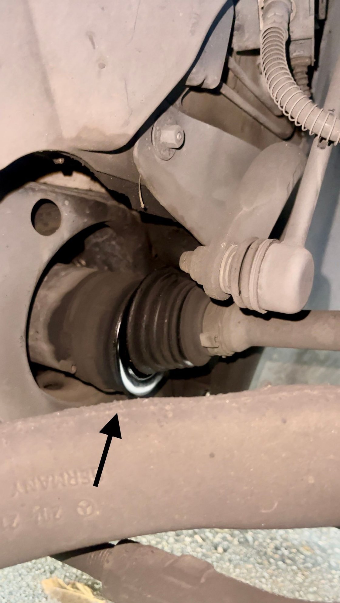

I drive a 2010 Meecedes Benz C 300 4MATIC Luxury. I've done a lot of research and I feel like it's my CV axle or motor mounts. I took pictures and this is what I saw. Isn't this the cv axle an would it be causing those issues?
those issues?

turn right or left , if you hear pop/clicking while advancing slowly then you have cv joint problems. If at an idle stopped your dash and middle console vibrate then a motor/trans mount should be done. Will you be working on the car because I've already done all this work and it's involving
