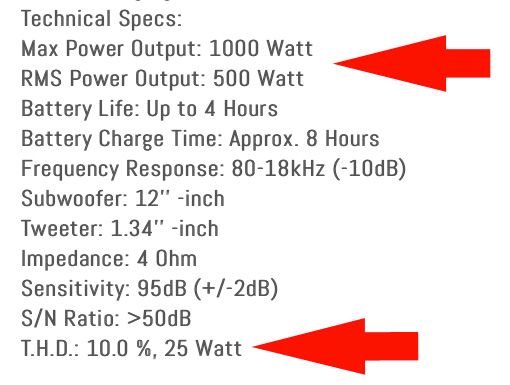

Headunit Power Ratings
Here is an example of the absolute lack of "Truth In Advertising" for consumer audio power ratings. The product is advertised as "1000 Watt Peak, 500 Watts RMS". Reading further, this is actually "rated" into 4 Ohms, so that's "500 Watts Peak, 250 Watts RMS". IF IT WERE TRUE!!!! (See attached screenshot).
Then the specifications state T.H.D (Total Harmonic Distortion) of a whopping 10% @ 25 Watts. Remember this is into 4 Ohms, so into 8 Ohms this unit's amplifier produces only 12.5 Watts with 10% distortion. So at the 5% THD distortion maximum that the FTC requires for all amplifier RMS ratings, this "1000 Watt Peak" amplifier probably does not even produce 6 Watts RMS into 8 Ohms without exceeding 5% distortion
The MB Audio20 non-HK Logic7 headunit will produce 100 Watts Per Channel into 2 Ohms at less than 1% THD distortion. If you use 2 Ohm speakers, you have a full 400 watts RMS at your disposal. Not too shabby. Recommended is just replacing with another OEM headunit, then upgrade your speakers with quality aftermarket 2 ohm drivers. A well referenced thread is: https://mbworld.org/forums/c-class-w...r-upgrade.html
