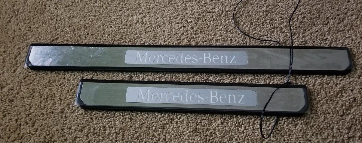

Yeah, like these?

nah...this!

Originally Posted by C0d3Sp4c3
nah...this!
I went back to check mine. I also got them in 2013. The back sills fine. They also say W211 on back.

The more I look at your set, the more I like them. Those 4 raised lines are an amazing look.
