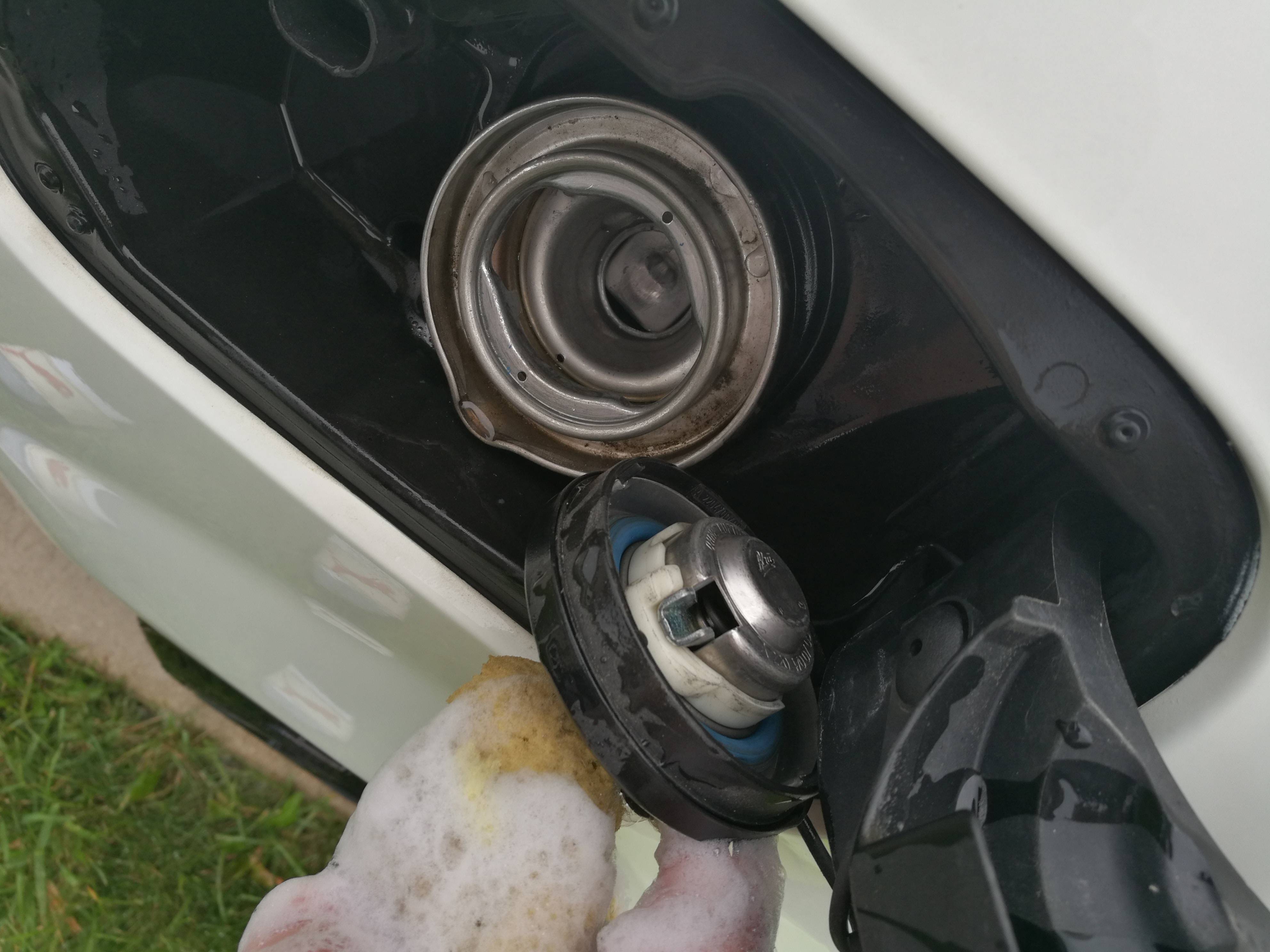

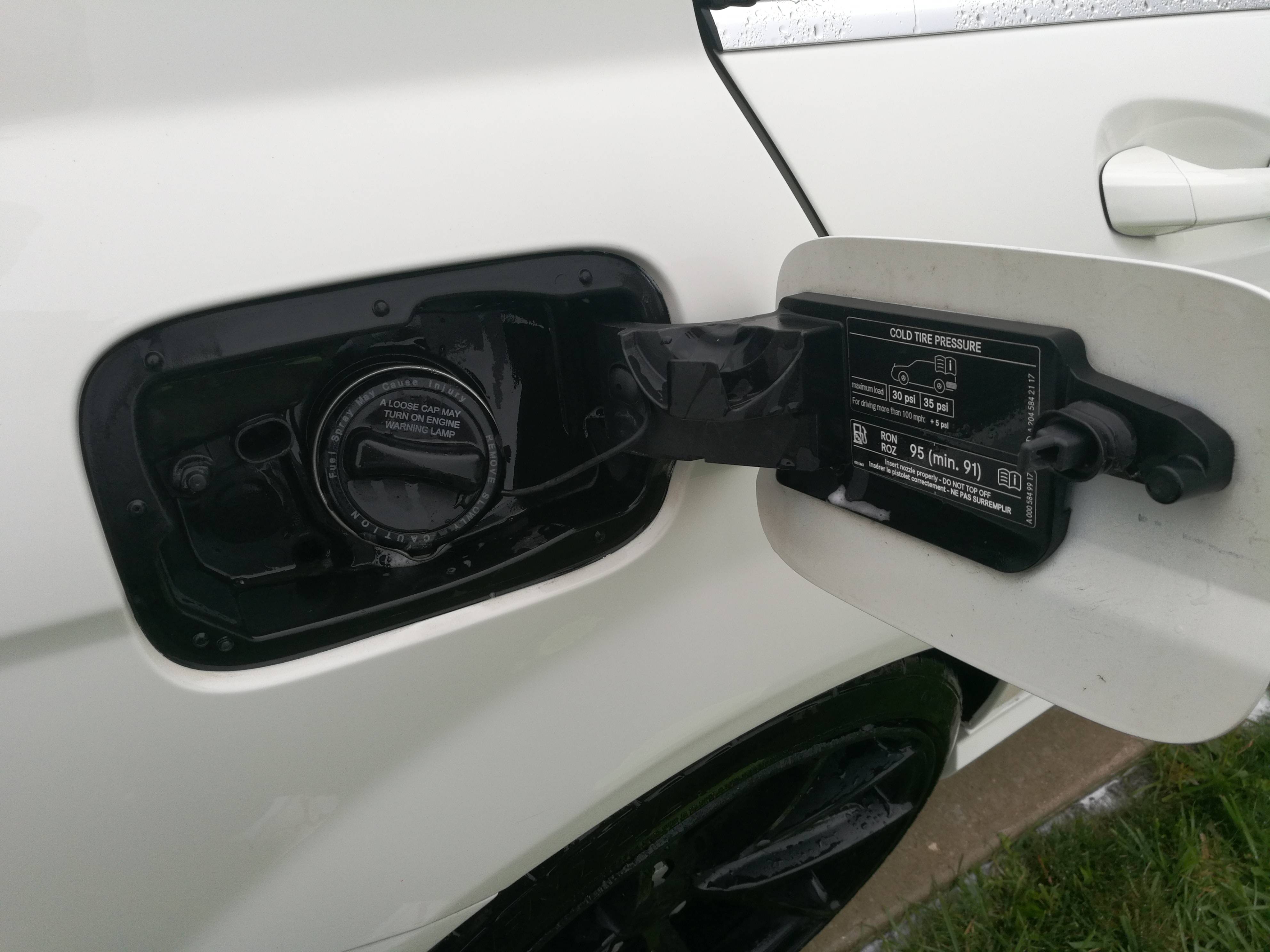

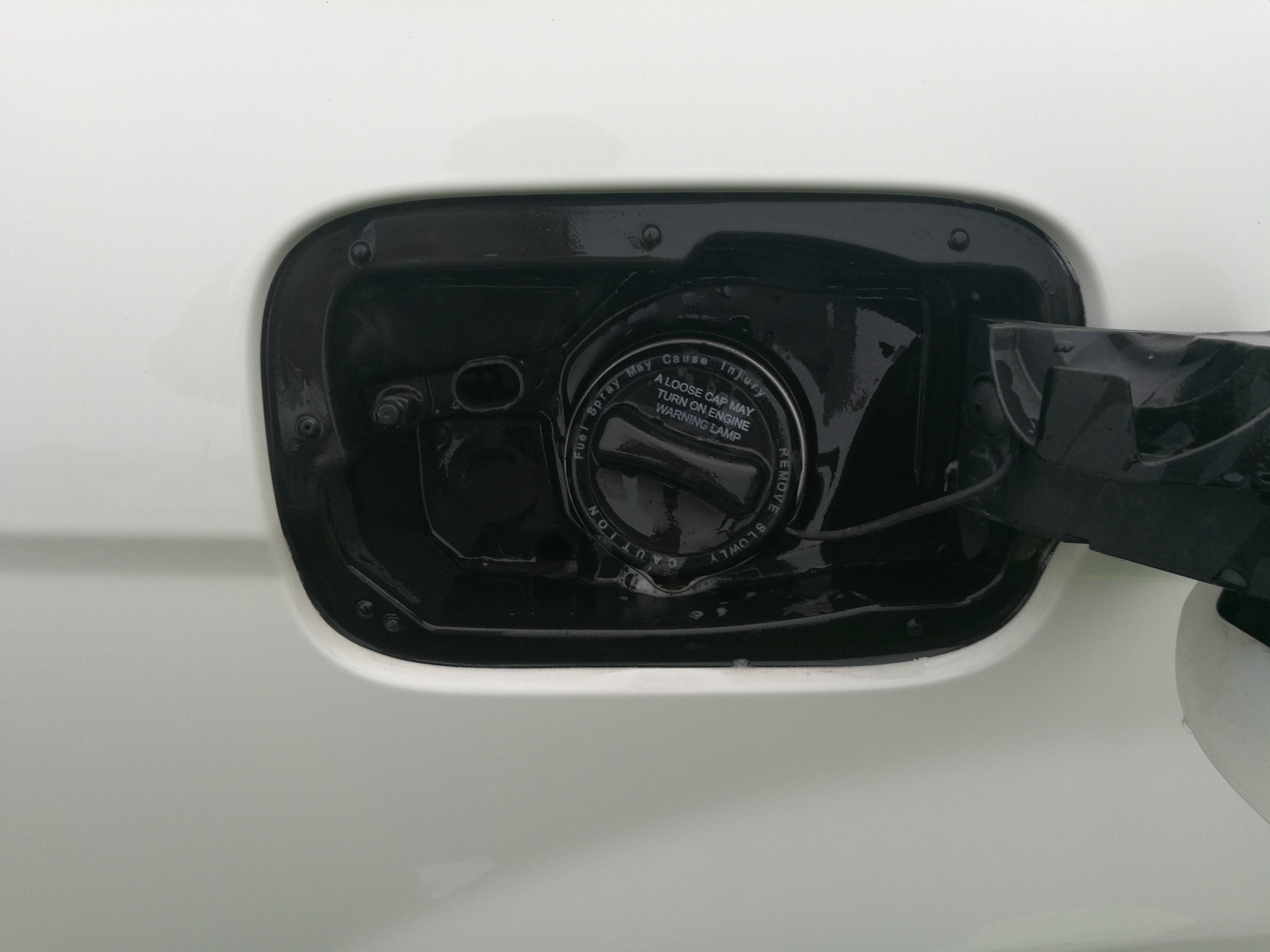

Ok, I just realized something. Marko has been saying fuel DOOR, I've been saying gas cap...not the same thing. Mine is worse I think but either way we're screwed.
Anyways, I was washing my car before it gets to be 30 degrees (F) tomorrow, and I got to the cas cap, and I figured, hm, let's see how much water gets in.
a LOT.
And then I took off the cap, and you can see how much got around the ring THERE as well (on the black plastic). On the bottom of the metal ring, you can see where water builds up, and I remember seeing this in winter.
Now, water IS supposed to be able to get into this I guess because it doesn't affect anything ((supposedly)) and as you can see there's even a drain hole at bottom left of the gas ring.

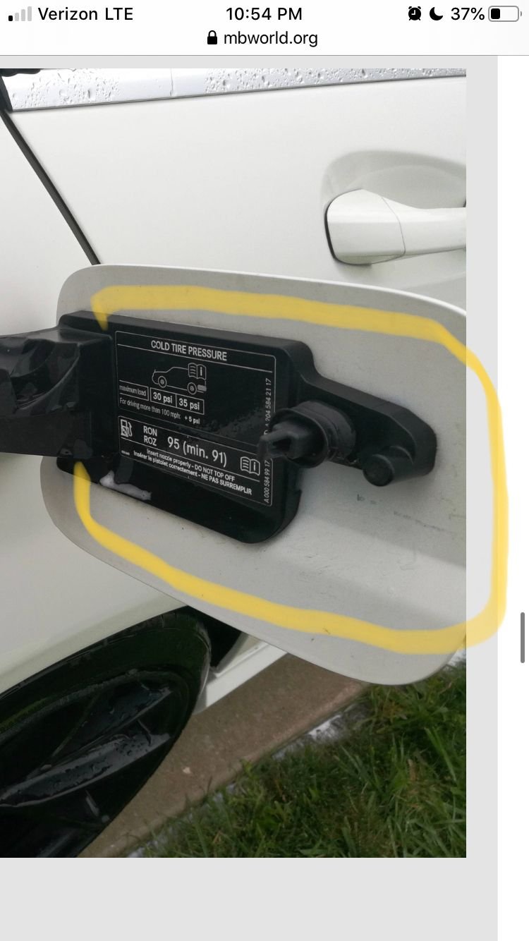

Lastly, and I’m not sure how much compression there is, or what/if any compromise this would do to the release/lock mechanism...
is to add more of a seal on the door...You’d have to decide on thickness...
