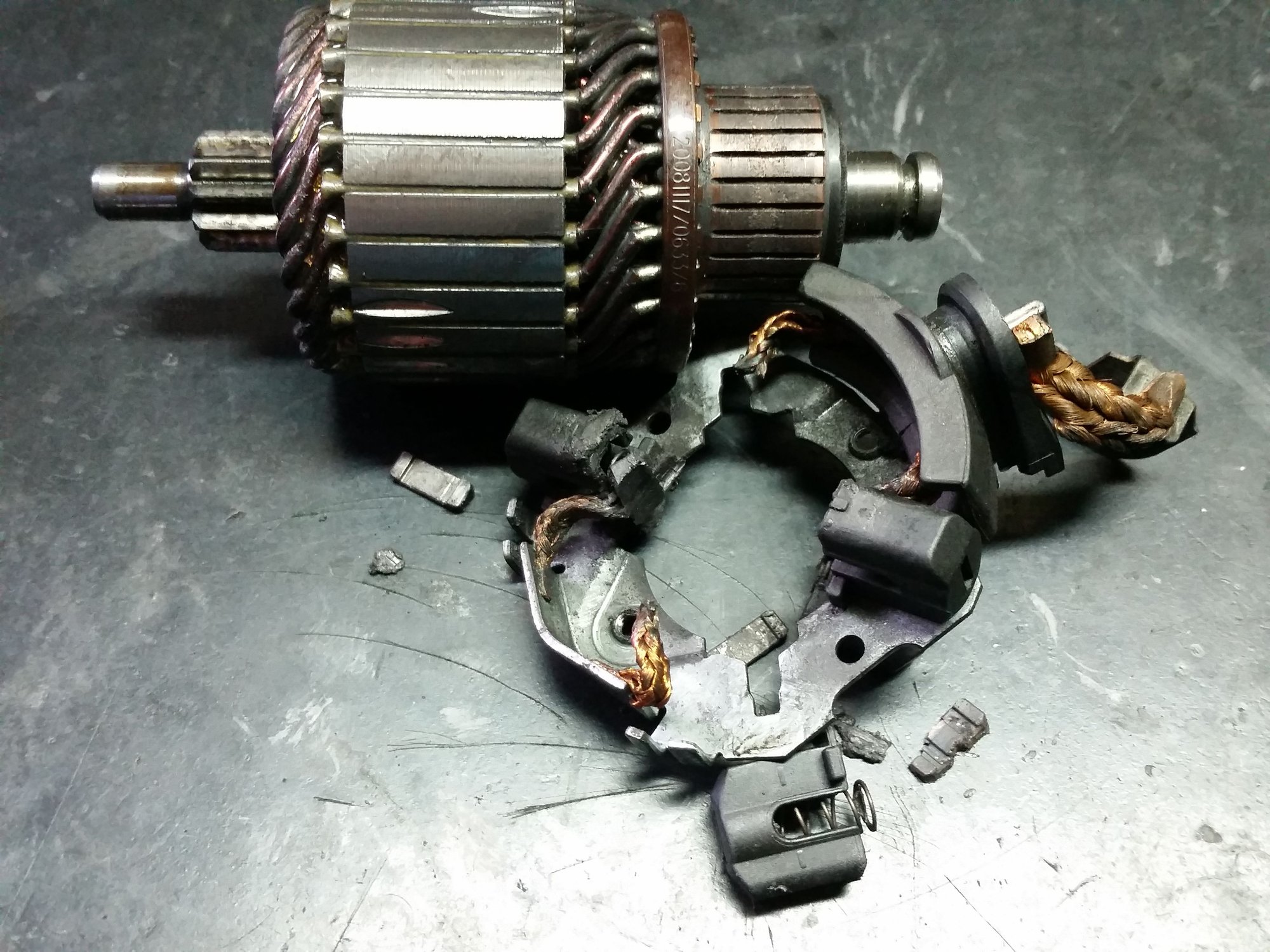

Old starter brushes totally disappeared, speedo has 125k on it.

Well, It was the starter motor. The brushes were completly stuffed actually they had vanished....
Looks like time to buy a new starter. I wont do a repair on it as it looks beyond that.

Mine was exactly the same as yours, brushes totally gone just wires hanging in the breeze.
