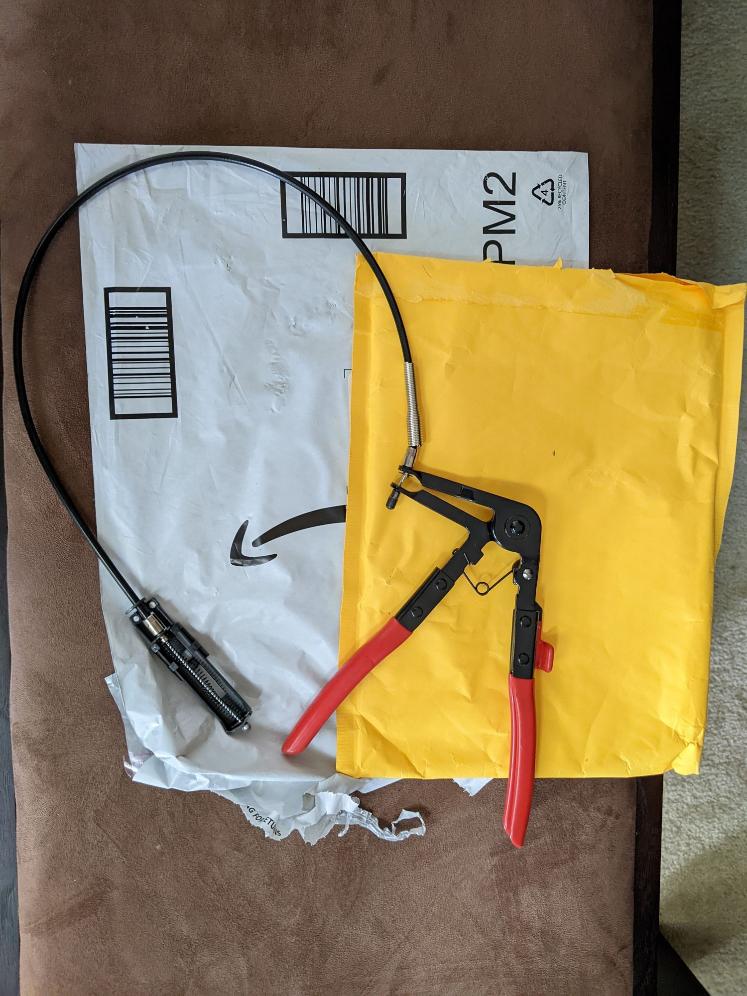

Sorry it didn't work out. I had to purchase flexible hose clamp pliers a couple of years ago to replace the coolant expansion tank on a Boxster. A bear of a job. It was still difficult with the pliers but would have been impossible without them. I hope your oil leaks are a thing of the past when the shop replaces the housing and gasket.

I did order one the flex pliers from Amazon and just received it, but don't foll like crawling under car again, lol.

I have been thinking, since I can remove starter in less than 20 min, why not try one more time since I have the clamp tool. I am planning to tackle the gasket once again.
Question to the ones who have done this, how difficult it is to remove the hose from the housing after loosening the clamp with this tool now, which prevented me from finishing the job last time. Do i need anything special tools? I know the space is very narrow.

The inside surface of coolant hoses often bond to the fitting. A small pick between the hose and the fitting to release the tension usually works well. You can also use channel locks to rotate the hose back and forward but you run the risk of damaging the outside of the hose with the jaws on the pliers.

How did these hose clamp pliers end up working? Were you able to get the hose clamp off with these once the starter was removed?
