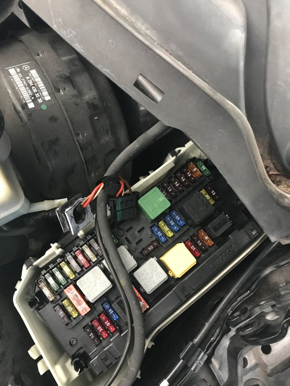

On top of the trillion things I am facing while trying to fix the car, I found out that the car has a short as well. I clamped the test light to the battery negative terminal and touched the probe on different parts of the car, the light came on dim and flickering. I checked it with multimeter and got a few voltage on the meter.
I tried the process of elimination to find the culprit by leaving the test light lit and removing the fuses one by one on on both frontal fuse box in the engine compartment and trunk box but the light never went out...There are no other fuse boxes in the car...
Would oil on wires and connectors
Runderneath the car cause a short like this?
does this connector supply the power to all the fuse box. I did not get any Voltage when I checked it

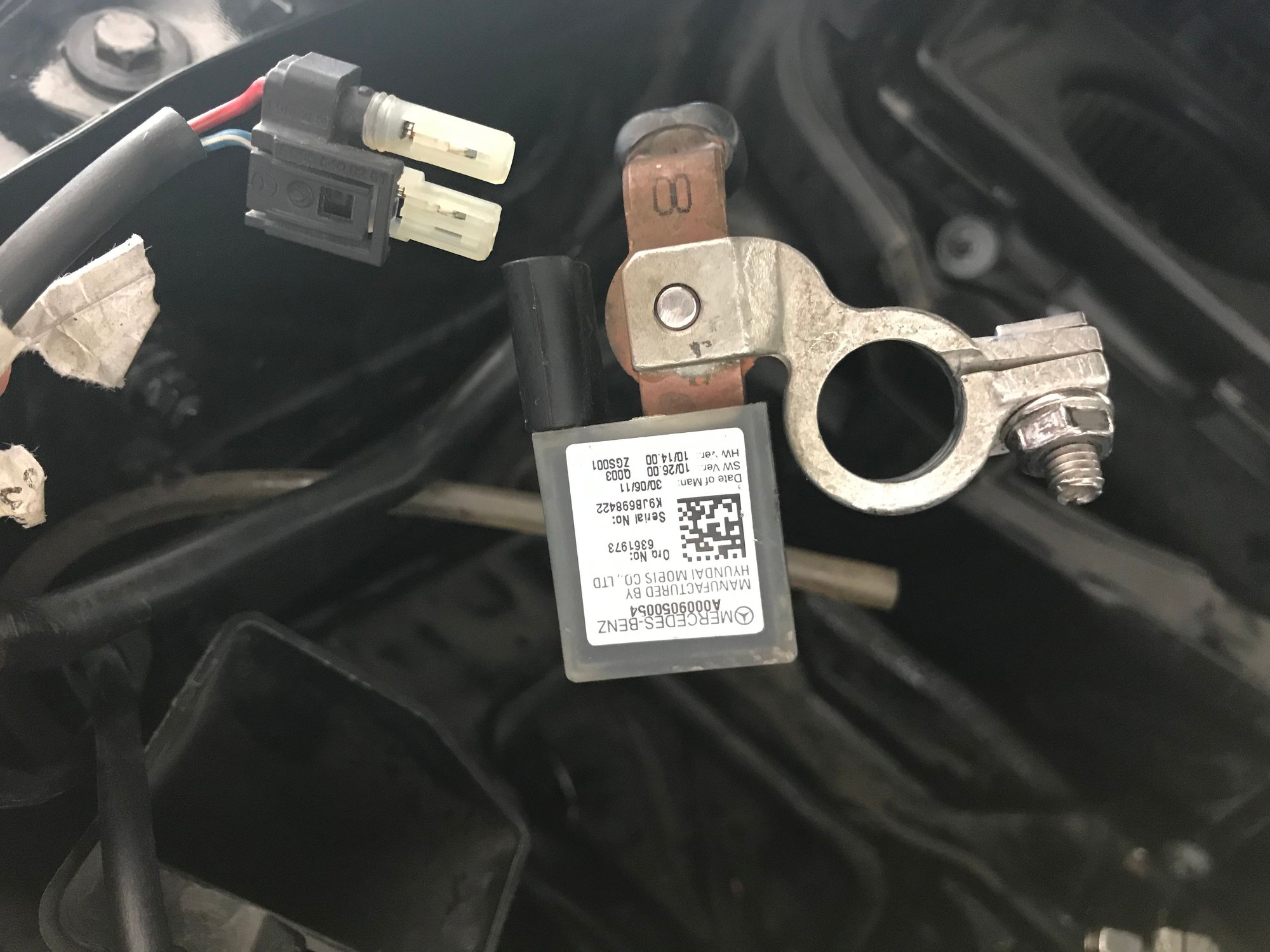

What is the function of this relay attached to the negative terminal of the battery. Is it Possible that I messed it up when I accidentally Touched both ends of the cable.
would the car Start despite the seats are disconnected and out of the car?

That Hyundai component is to do with Stop Start , also the way it charges the battery ( Smart charging ) because of stop start , also something to do with brake HOLD too ?
