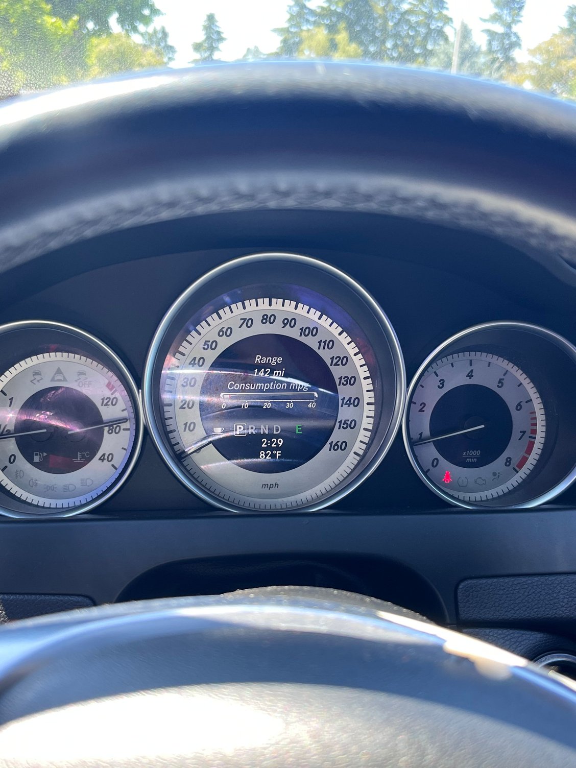

I really need some advice, any advice will help. I got this 2013 c250 about a month ago, and changed the spark plugs on the 3rd of july, everything was running perfect the spark plugs I installed where NGK Rithinium thinking they would be better, and about a week later the car started misfiring I first thought it was the alternator but the check engine light came on and turns out cylinder 2 misfired I changed the spark plugs again to NGK Iridium’s and nothing changed, I tried also changing the coil still misfiring so I put the original back on I also switched cylinder 1 and 2 and still only cylinder 2 I also tried clearing the code and reinstalling everything but the code is “permanent” please any advice? Also I gaped all spark plugs to .32

i haven’t done a compression test but it only really shakes when it’s up to temperature and shakes really bad when I put it in reverse and a little less when it’s in drive, I’m worried it’s my fuel injectors because it does smell like gas in the engine bay but don’t see any liquid anywhere I also just changed the valve cover gasket since there was oil a little in cylinder 1 and 2, i also thinks it’s my fuel injectors because on the mpg screen the white bar is all the way down and only when I’m driving it functions correctly.
