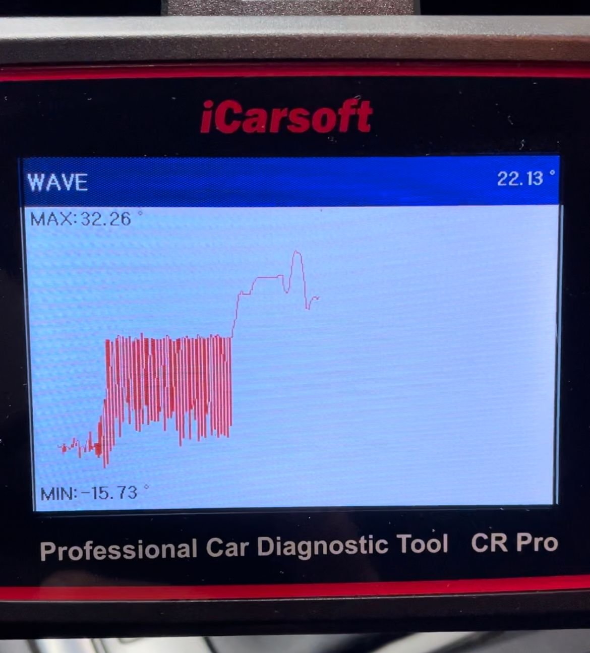

Ignition curve oscillating at idle from approx. -10 to 12 degrees, gets normal at 1500rpm and above.

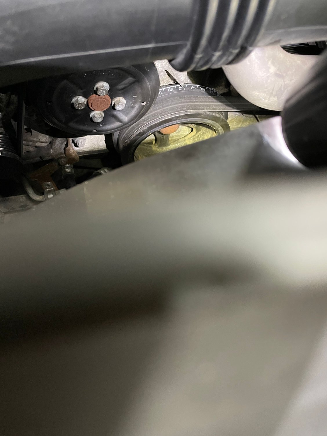

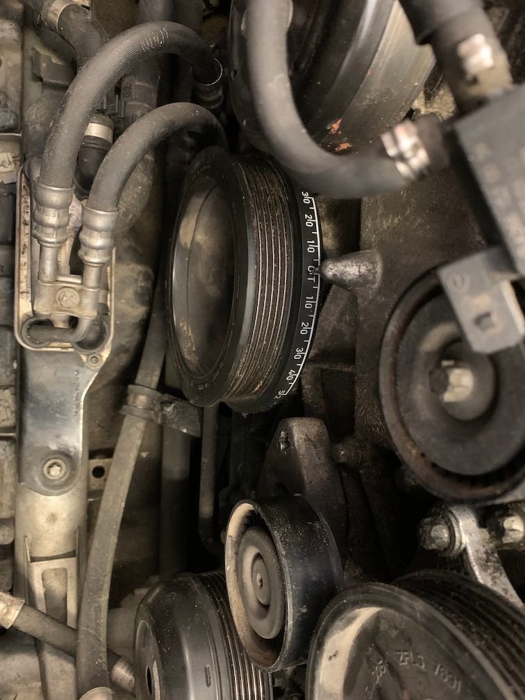

The intake and exhaust camshafts look out of alignment. With the crankshaft at TDC, the arrow on the camshaft housing should align with the camshaft and the camshaft adjuster. I think you need to resolve this issue first before addressing any of the other fault codes.
Intake Camshaft
Exhaust Camshaft
Crankshaft @ TDC
