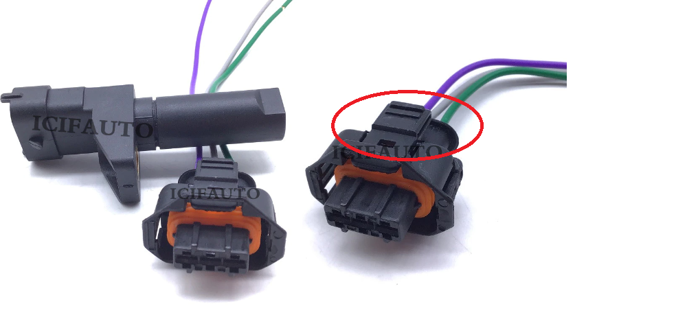

Found these pics on google, looks like you'll have to push down the tab I circled in red to lift off the little stub on the far left

thanks for the pics. Sat morning I'll get this tackled one way or another. Im not going to let a $40 part beat me lol
