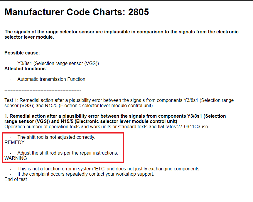

So it's been around 35k miles and 2 years later since I originally started this thread. The last month the car has been sluggish, with lots of road noise. A week ago the same CEL codes appeared.
Again, I just changed the transmission mount. As with the original post, car is driving and shifting smooth and road noise is gone. The last transmission mount was a Corteco brand, this time I used a Bilstein.
I guess these transmission mounts don't last very long and it needs to be part of your maintenance. Going to change my parents C300 and see it helps their car too

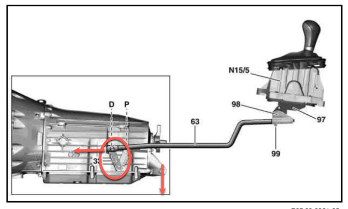

Interesting. I wonder if the worn mount lowers the transmission enough to mess with the shift rod somehow.

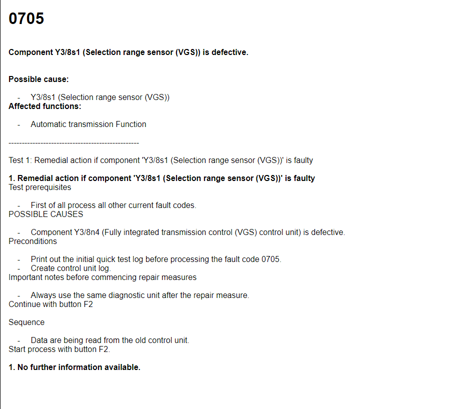

Interesting, I didn't know failing mounts can trigger a fault code, I got curious, what is that code exactly?
Old Feb 12, 2025 | 07:18 PM
RS250_Chester's Avatar
Joined: Dec 2021
Posts: 13
2012 C250
P0705, P2805 have been consistent, I have also seen P0606.
Old Feb 12, 2025 | 07:35 PM
W205C43PFL's Avatar
Posts: 32,505
Likes: 6,347
Hmmm, I see, transmission range sensor.

From the diagram @TimC300 provided, a collapsed tranny mount could definitely shift the lever arm further than it is intended to be. And a ½" drop would seem significant.
