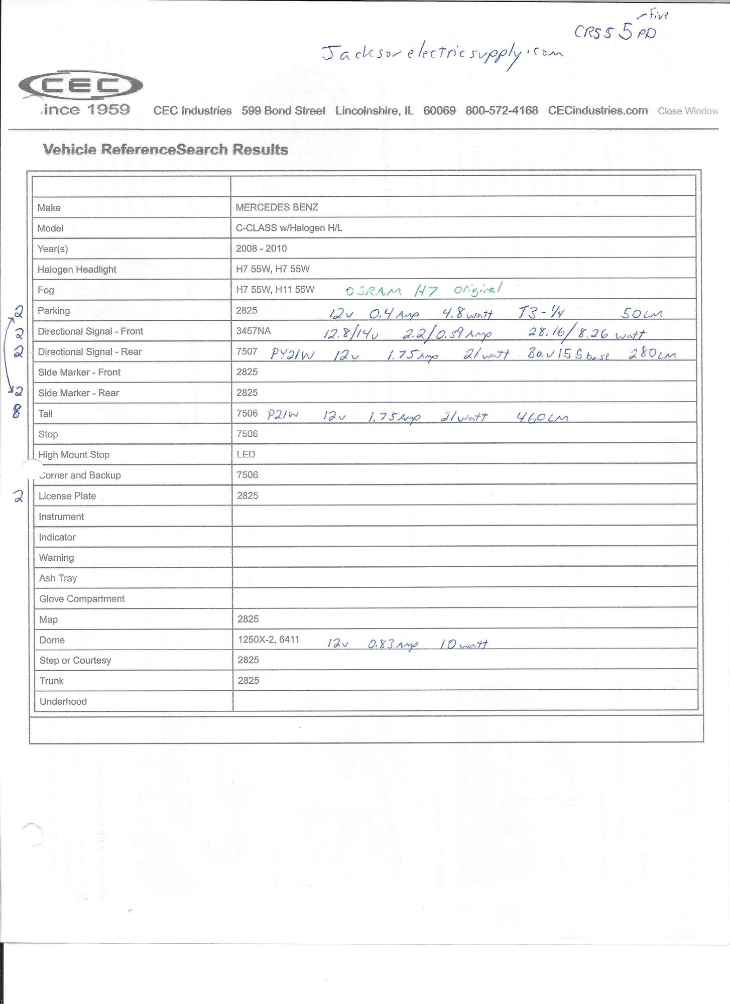

Curious you say you get a front lamp warning, what does the warning specifically say? In the headlight housings there are 2 bulbs each in the "eyebrow". If one is out it may be hard to even tell, especially during the day.
heres a sheet telling what bulbs are required. This is for a 2010 C300 4matic sport but im assuming it should be the same.
I went and looked up the spec for each bulb which is why I wrote them down. Alot of bulbs have the same base or even look the same, but they have different wattage which can throw things off and get warnings popping up. All of the above bulbs work perfectly from my experience. I went and replaced most of them, keep the old bulbs wrapped nicely in the trunk behind the fuse panel in case one goes out at night and I need to replace, to keep from being pulled over mostly. I even have a pair of spare H7 bulbs for the low beam and/or fog light. But I did install an hid kit for the lows, when I first got the car I couldnt see anything driving at night the halogen lights they are so bad in my opinion. Thats simple plug n play so i can easily swap in the H7 if needed quickly.

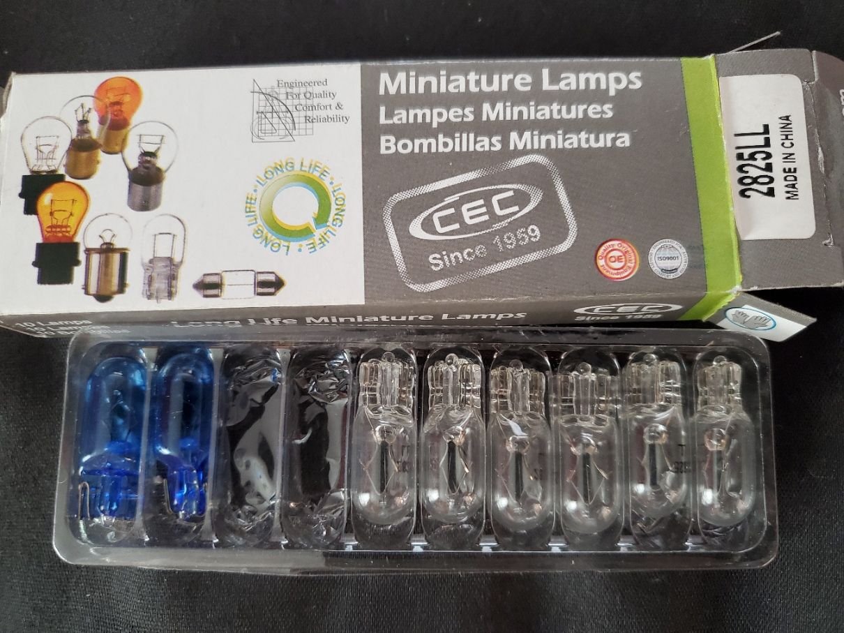

These are the majority of the bulbs in the rear, I think 4 each side.
* The blue bulbs are the original Mercedes bulbs. 1 bulb in each side of my car burned out so i replaced with just regular 2825LL bulbs, which look brighter. I ended up just removing the other 2 blue bulbs and replaced them all so they look the same. If you want the Mercedes bulbs they have them on FCP Euro for a few bucks each.
These are for the front parking lights (eyebrow), license plate, and front side marker. Think these are also used inside the car.
Front and rear turn signal bulbs.
Just for fun ill show what I have in my fog lights. I was searching around for the brightest whitest H7 bulbs, that wont burn out every year and came across these. Ive had Silverstar Ultra in previous vehicles and these seem similar but less expensive. They are definitely brighter and whiter than the stock bulbs that were in there.

Wow really appreciate the detail in this, I did just run out to the store and noticed that the first fault that come up is “auto lamp function inoperative” it’s then followed by all the bulbs that are “bad”. I think this might be the sensor in the windshield, what do you think. I’ll maybe check all the bulbs today or tomorrow because I still need to clean up the car today.
When I’m doing the front brakes in the next couple of days I’ll check all the ball joints maybe spray some on silicone just to see if it helps, can’t hurt I guess, and the rear sub frame for rust. I’ll also register to check recalls. When going over bumps there’s a slight noise from what I found it might be the strut bearings. Like everyone pointed out it’s not things that make the car un-drivable more like cosmetic or ride quality. Just wanted to see how I can clear the bulb faults and how severe the creaking and engine vibration might be. Other than this the only other “problem” is the driver seat tear but I’ve been a basically most of these c300 have this problem. I ordered the bottom seat cover in leather, it says it fits 2010-2014 seat but they look the same. It’s worth a try. I also got some Techron, might try that.

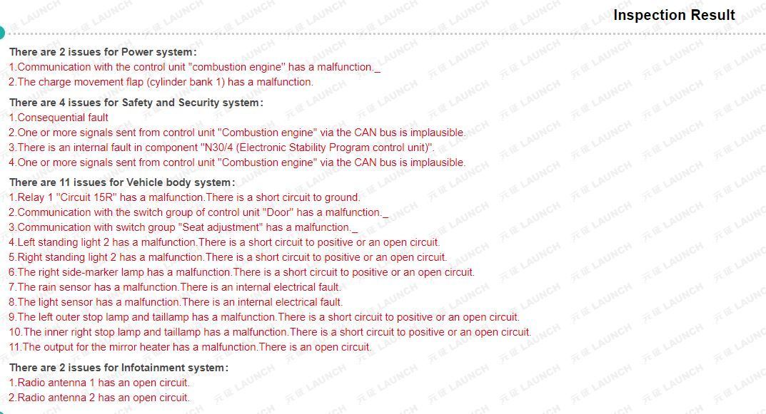

Just wanted to hop back on here after scanning the car
So I used my scanner yesterday and pulled a good amount of codes from it, some stored but some are current and stored. I attached the screenshot of all codes and if they are old or not. From what I can tell is I first need a new rain and light sensor because it says its broken and maybe that is somehow causing the issues with the bulbs. And the car does feel a bit sluggish when revving, like if I just tap the gas pedal quickly, I can take my foot off but there's so much delay that the revs still go up even after taking foot off. I did read that I can try to reset the transmission or ask dealer if there's an update, car drives and pulls fine just slow to rev and kind of late to drop a gear when passing someone on highway. The other code that worries me is P0521, could this be related? I had a 07 gl450 before and also had an issue with the intake and it also revved slow like this one. Not sure if this is just how they are or if the intake flaps are the issue. Can I easily check the intake? Without taking it out? I found a whole intake online for like $155-200. Would I just need to change it out? How big a job is it? Thanks to anyone who can look this over and help, just want to have it running well and no worries.

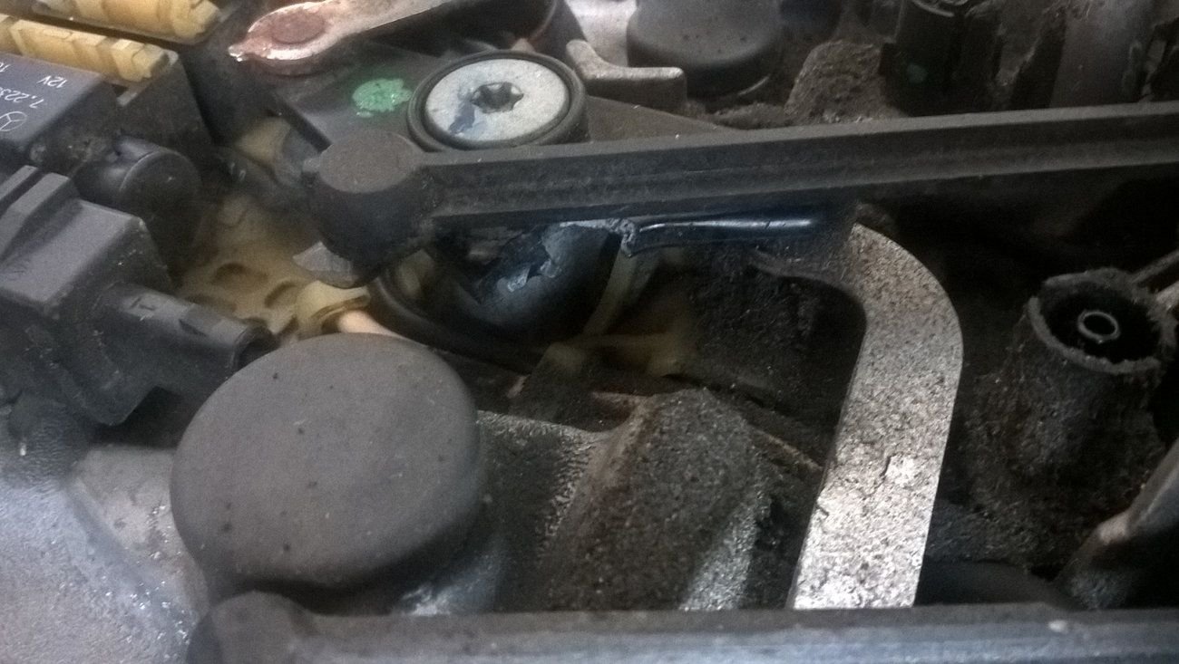

I searched the P0521 issue and someone said there air flap lever was broken. I think these are visible on the front of the intake, just take a look and inspect everything. Im not recommending the parts below, just showing what they look like.
Heres a good thread on the P0521 code. Has the fix, in there case.
https://mbworld.org/forums/e-class-w...or-0521-a.html
For the stored codes I also had a few when I first hooked up my recent scanner, I erased them and they haven't come back since. I do remember the abs warning light coming on awhile back, was just a one time thing and probably why the code was there.
I had this, erased and hasnt come back.

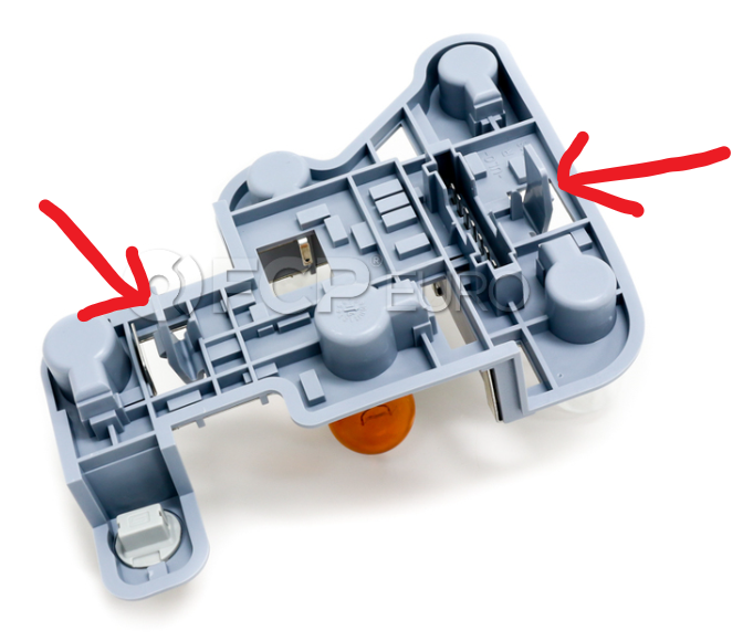

And back to the tail lamps. Ive read a few people have had issues with the tail lamp carriers and/or wiring harness. Partly why they had a recall, as i noted above. inspect the harness for melted plastic. Inspect the carriers for corrosion. Double check for burned out bulbs. I guess its so common FCP offers a repair kit that has new carriers, connectors, pins and grease.
This photo is from someone with a tail light issue.
I'll do another system scan tomorrow to see what came back and what didn't. When I cleared the p0521 it didn't come back right away after starting the car so maybe it's not that bad yet, will take a look tomorrow at all the plastics on the intake tomorrow. I know the upgraded parts are like $160 would you say it's a good idea to a whole new manifold to not have to worry about anything inside breaking? Problem is it wouldn't be the pierburb or OEM one its an intake off of amazon from a brand called MITZONE don't know anything about it. I would of course use new gaskets and such but then again on amazon there's a repair kit for like $30. I don't want to go the cheap route but what would be better, replace broken parts with quality ones or replace the whole thing with ok looking parts? I might have to take the bolt holes or clean up some other things on the cheaper one but I guess I'd be fine with that.
As for the lights, I'll check tomorrow for the carriers having any signs of damage but might hold off on replacing bulbs because they work for now and after seeing the code for a faulty rain/light sensor I'll replace that first. That's also the first fault that pops up as soon as I start the car "Automatic light inoperative".
I ordered one, should be here next week, if faults still show up I'll start going bulb by bulb.

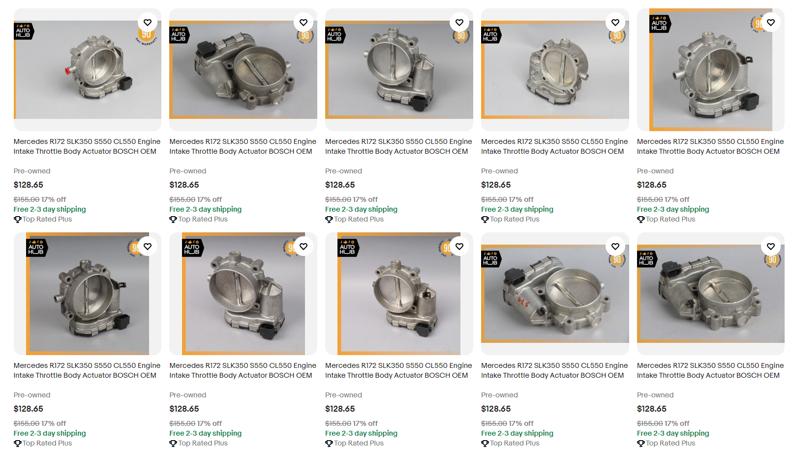

I have no idea about that Mitzone intake manifold, i see alot of them were sold on ebay. I would look for whatever has broken first and then decide what to do. If it is just that lever part they sell kits, or maybe can find just that specific part. I did a quick search and on Partsgeek they do have kits that are not much money.
I seem to have signs of oil all over my intake manifold im trying to find the cause of. i will say if I had replace my manifold i would most likely get a used one off ebay, i already have a few lined up in case. Found a few low mileage, well much lower than what my car is anyways, and they look very clean no oil. And some come with everything, fuel rail, throttle body, fuel injectors, basically look bolt on and go minus ecu. Some people arent comfortable buying used, ive had very good luck so far.
For the tail lights im just saying remove the carriers and look around, can easily tell if the wrong bulbs were installed just looking. Look for corrosion. The carriers pop right out, just push the plastic tab up, or down I forget and they come right out.

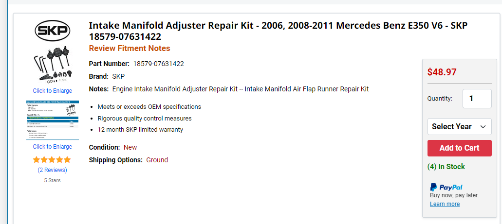

Found an interesting article on FCP about replacing the M272 intake manifold with a plastic one. Shows it does away with the failing flap issues and adds hp. Guess it requires larger throttle body and may need a tune afterwards.
Heres the article: https://blog.fcpeuro.com/solving-fai...ODYwLjI3LjAuMA..

I just found that article interesting because it seems it does away with the flaps altogether so theres nothing to break again.
I have no problem buying used parts, most times I feel better buying a used OE part than an aftermarket part. Perfect example is my purge valve, my car had a check engine light and the most common issue with that code seemed to be the purge valve which i then confirmed by listening to it and it was not working, no continuous clicking sound. Bought a used Mercedes purge valve off ebay for something like $12 shipped and its been working great for 2yrs now. When looking for a replacment I just made sure the seller was not known to sell junk parts.
Since seeing oil residue on my intake manifold i have been looking around at used replacements. I have a few lined up from one specific seller i bought from before with very good luck. They are around $200 and come with everything still attached, throttle body, injectors, fuel rail, even the ecu brackets and mass air flow sensor. They look very clean, no signs of oil. Im not saying this is the way to go, but I probably would go this route. the id have a bunch of extra parts along with it, the extra injectors alone is a great plus. I can tell you where im looking if anyones interested.
Same with the slk350 throttle bodies, i havent done much research on if used are the way to go, but i found a bunch that look clean that would be worth looking in to.
