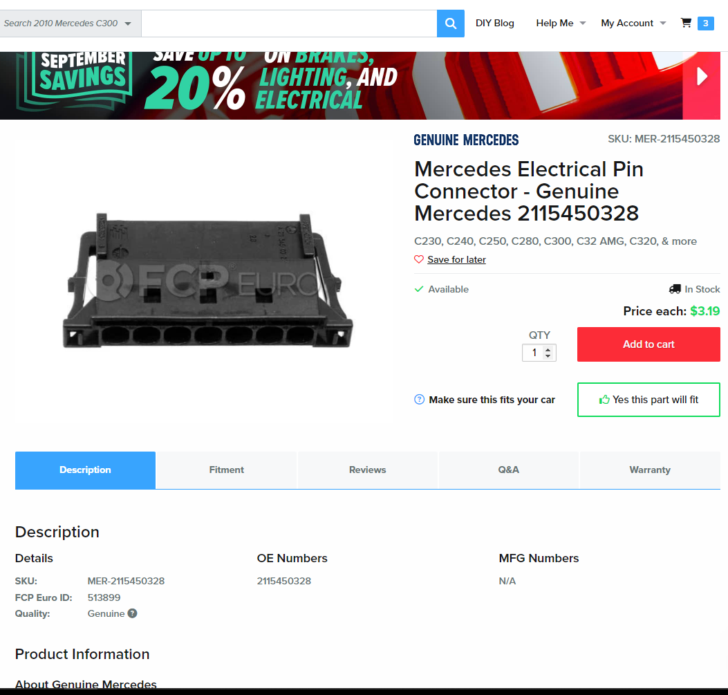

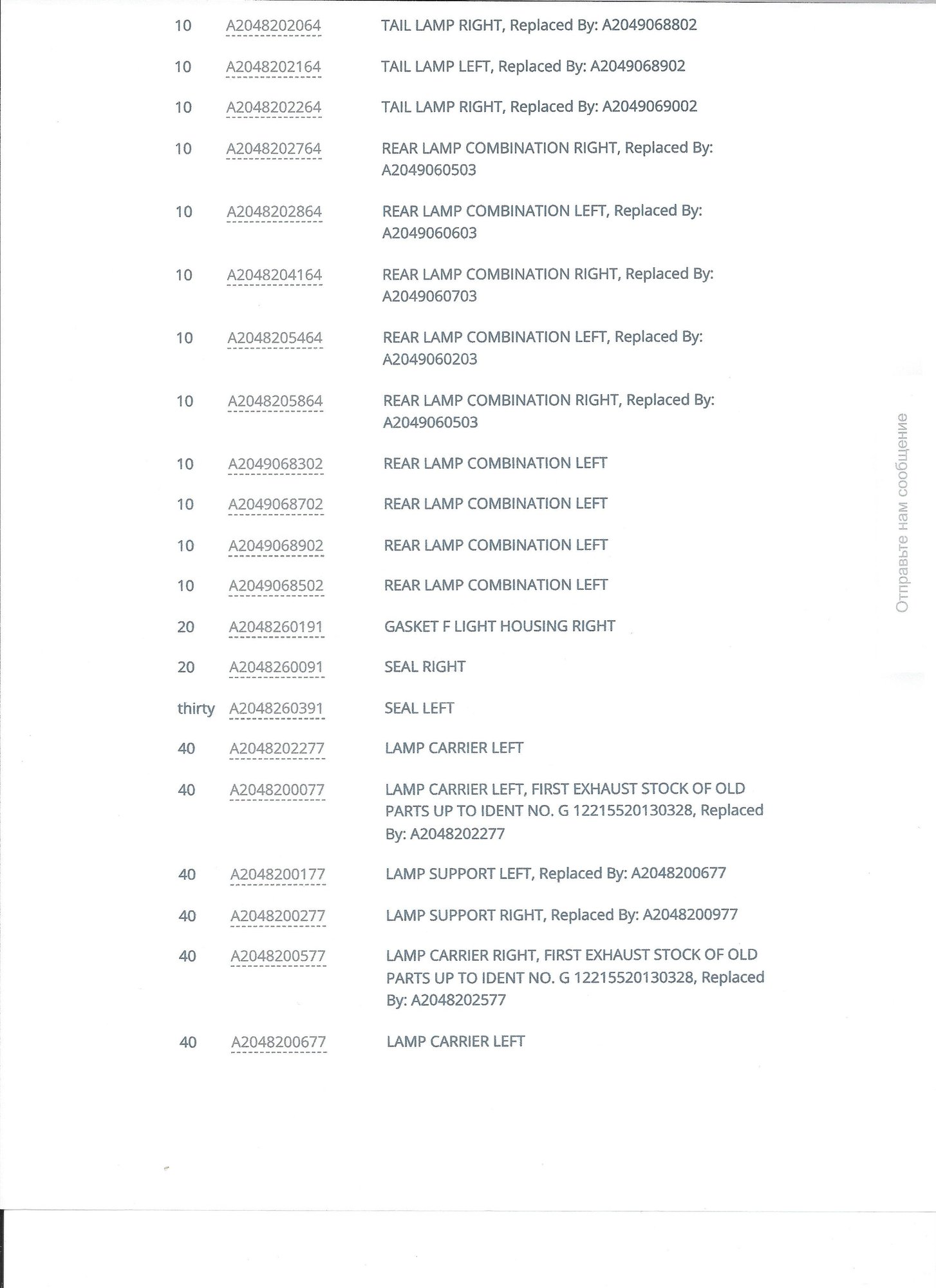

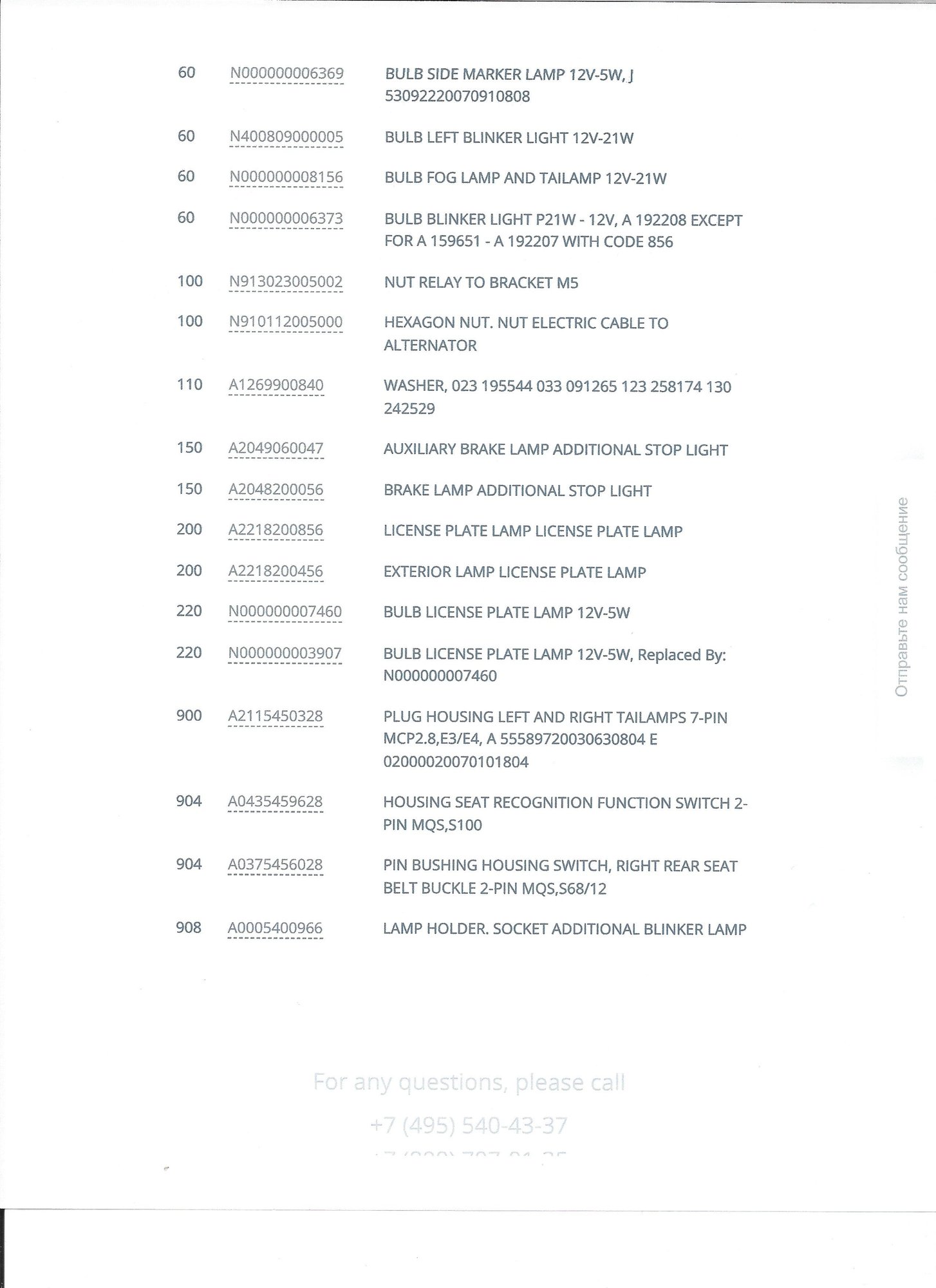

Heres the part#s and I think the correct wiring diagram for the tail lights.
