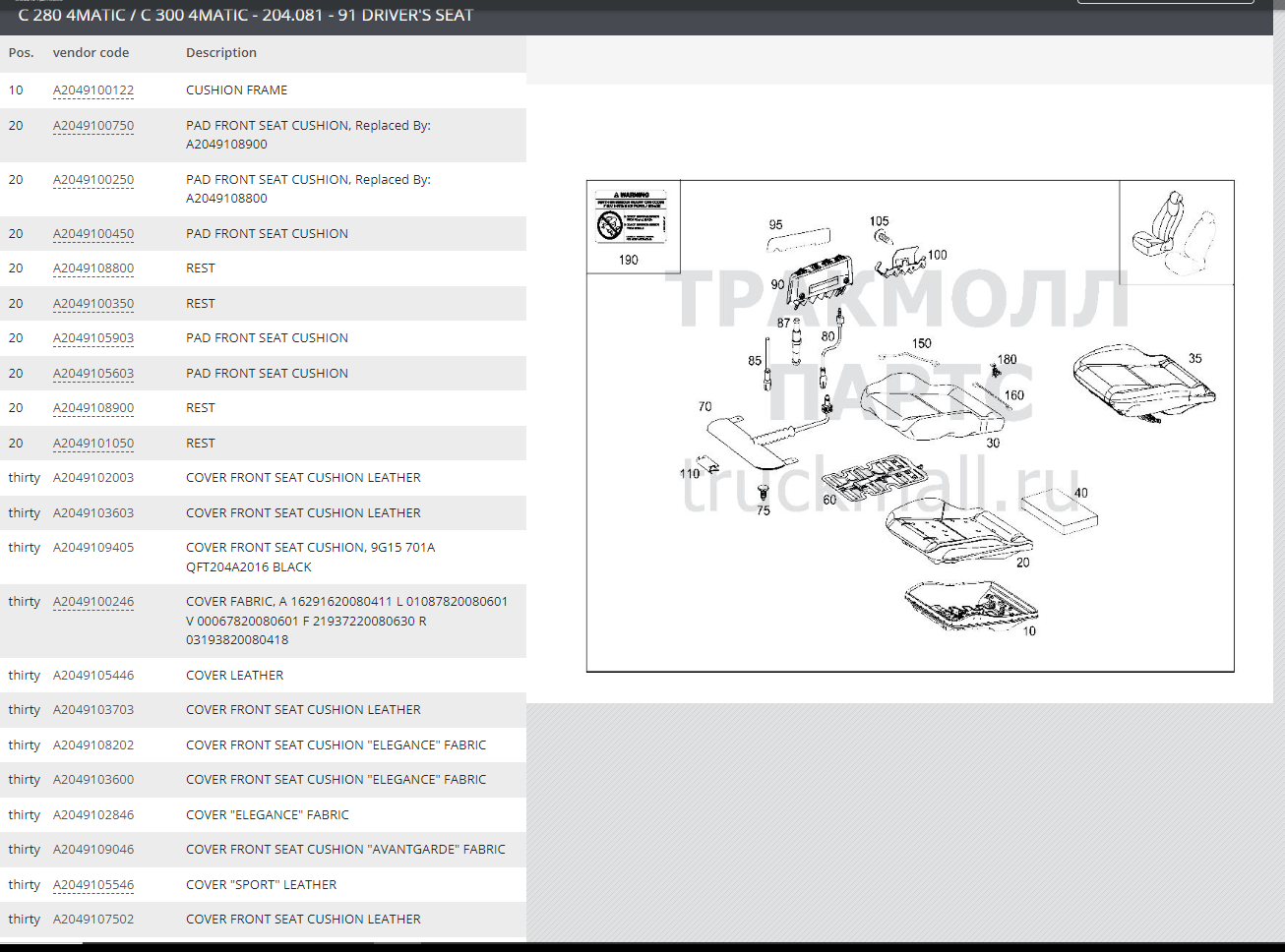

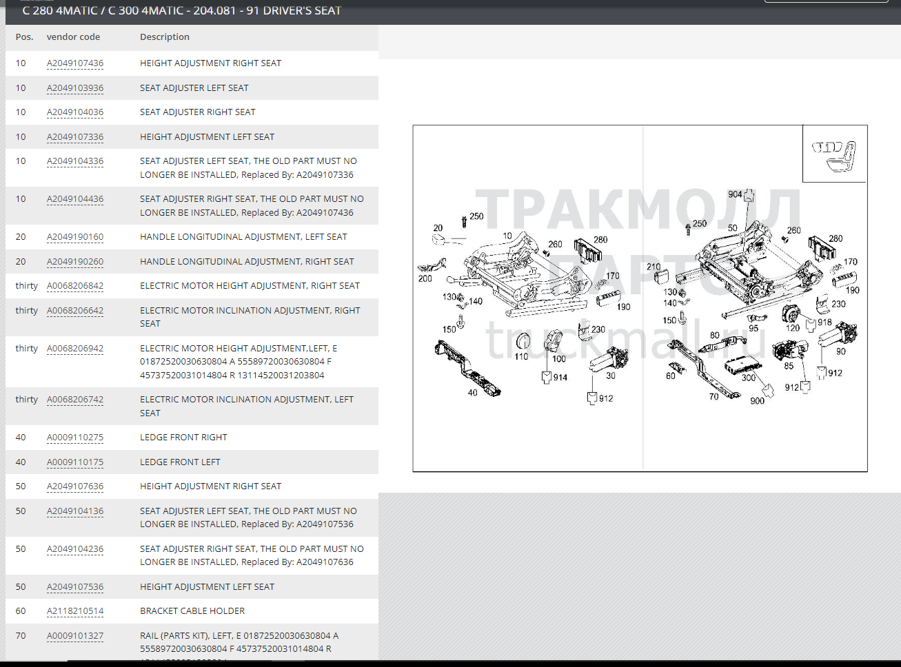

I never did it but it looks pretty straight forward if youre decent at working on things. Can replace just the cover or replace the entire bottom cushion part. Looks like most of the electrical stuff is on the bottom.

It's simple to remove the bottom seat cushion. Move the seat all the way back, fully raised, and the front tilted up as far as possible. On the underside, there are two Torx bolts (T27?) in two clamps that hold the front of the seat cushion to the frame. Remove these and pull the seat cushion forward and slightly upwards. If you have heated seats you will have to disconnect the plug for the heating element.

The heating element is integrated into the seat but not the seat cover so, no, you don't have to find a heated seat cover. I just took the bottom cushion to a local upholsterer who removed the old cover and replaced it with new MB-Tex. This was easier than trying to color-match the other seats.
