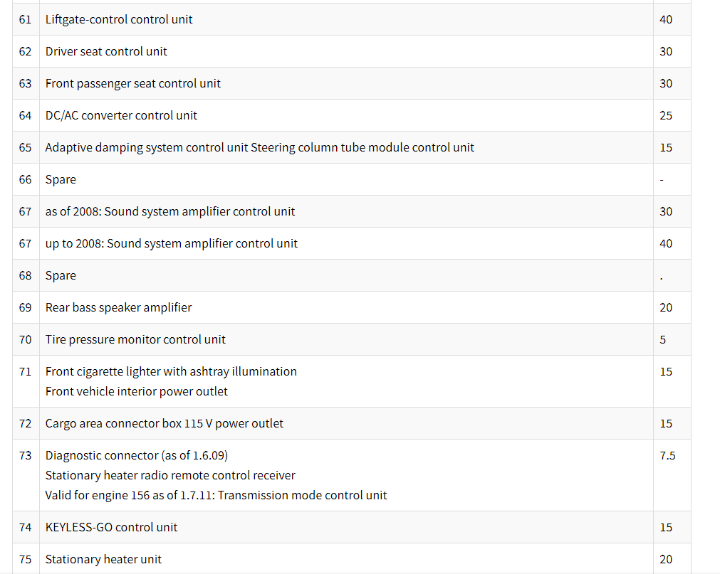

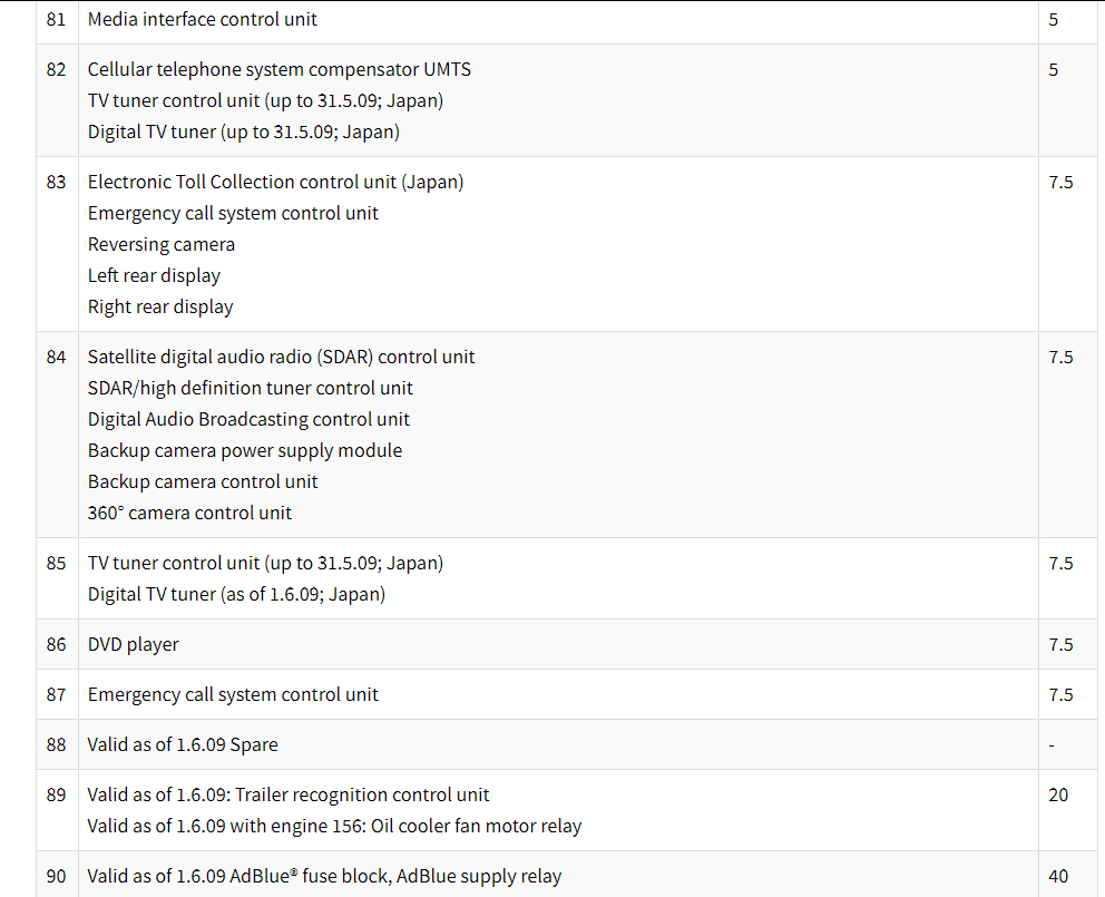

@TimC300 Thank you! Those diagrams are very helpful. I found the fusebox in the trunk on the right, but I didn't see the power amplifiers on the left side. I'm going to take a look at the amp and stuff, but besides a blown fuse, I'm not sure what else I should be looking for.

I havent touched the stereo in my Mercedes but in all my previous cars I always installed installed complete systems from head unit, amps and speakers. I did start looking in to installing one in my Mercedes but it doesnt look that easy, even the speakers in the door look like a project just to replace.
if i wasnt getting sound from my stereo i would start at the speakers and trace everything back to the head unit. Get my multimeter out and start testing. Is the speaker getting power, probably not so trace it back to the amp, is the amp putting out power? If not find where the powers going in to the amp and see if it is getting power, if no then trace it further, but if its getting power then it may be the amp.
If I were you I would try to be locating the wiring diagrams for your specific car. I know there are all types of different components in these cars depending on what head unit is in there.
Theres a few fuses in the trunk that are related to the amps and stereo. Like #67, #69, #81.

@TimC300 Thank you for the information, those fuse diagrams are very useful.
