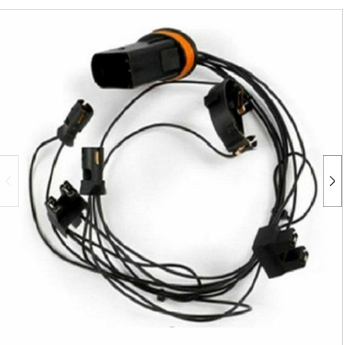

I looked through my parts diagrams and it does not look like Mercedes lists just a replacement bulb connector for the parking lights. They dont even list the harness. Seems they want you to replace the entire headlight assembly.
I did come across an aftermarket harness on ebay. Just to see what it looks like.
