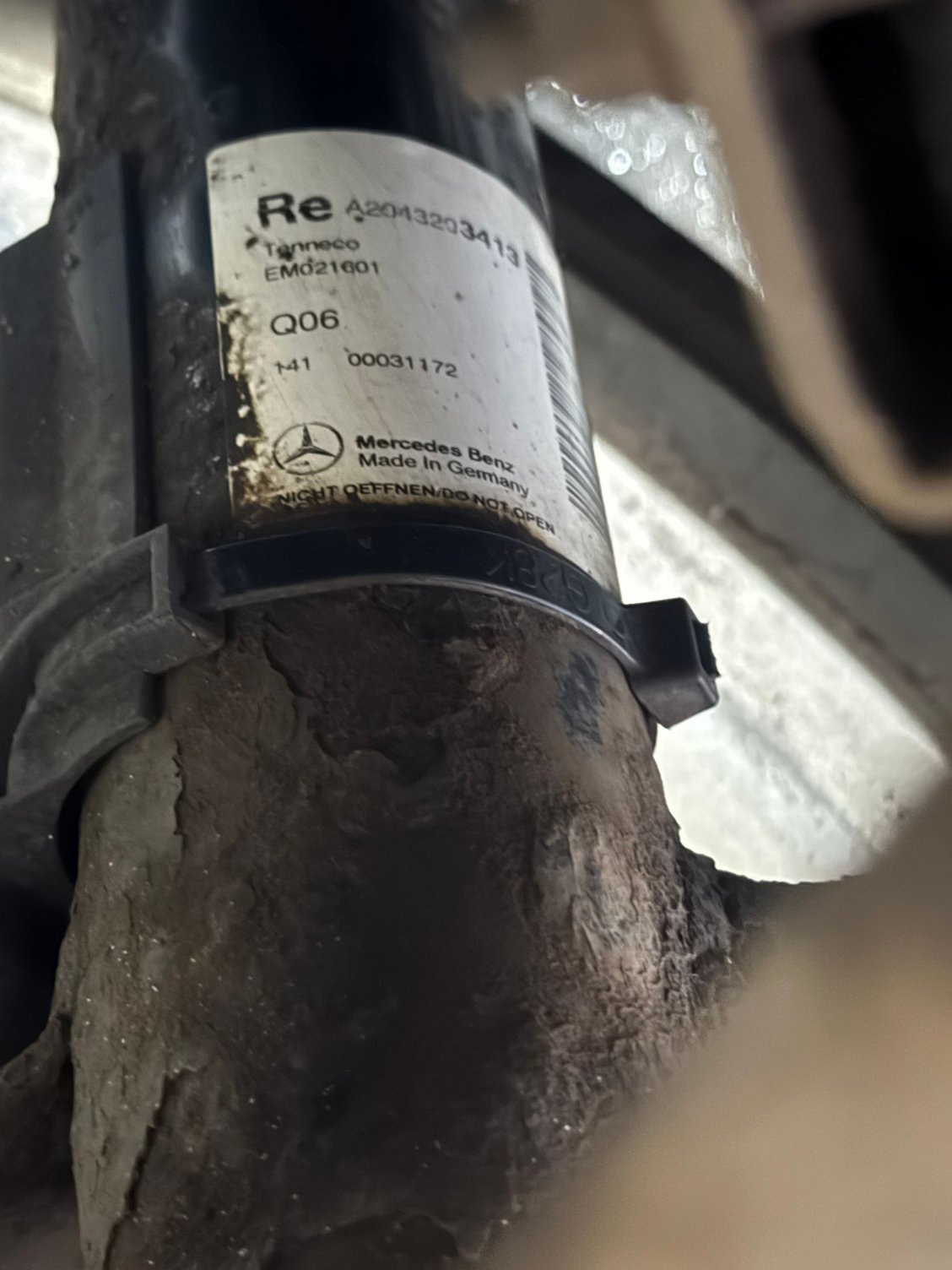

I have a 2008 c220 cdi sport which has a sport mode button need to change front shockers i been told i have electric shockers anyone changed these before any help which ones are they or can standard ones be fitted?
Thats the only picture i could get any help

If you fit standard you will have to do all 4 and code-out the active suspension feature. Make sure you get the correct standard dampers, limousine or sport, the length is different.
Monroe do the OEM electronic dampers C2508. Check their site. GBP 180 each on AutoDoc.

Seems you have the dynamic handling package which I know nothing about since not having it myself, I just have 4matic sport struts. I guess your struts have some type of connectors that either change the height or damping level of the strut.
Youre going to get alot of different part #s because all those struts will fit in your car. But most will not have the dynamic handling feature that you have.
When I was looking to replace my front struts i came across a listing for sport struts but when i received them they were for the "Luxury" model. The struts were physically taller than my sport struts by a few mm side by side. I needed to get my car on the road so i installed them while i looked for another set of struts, they fit, but they made my car ride a little bit higher by around 1/2", it was noticable.
I looked up the part# on the strut in your picture and not coming up with anything except for two websites offering a used set, from Ukraine. Im guessing Mercedes has since updated the part numbers many times like they do with all parts.
Best bet is to visit your local Mercedes parts dept with your vin # and act like you want to order a set, have them write down the replacement part #s.

You have 483 Vehicle dynamics Package.
Front Left shocker is A204 323 0900
Front Right shocker is A204 323 1000
From AutoDoc :
MONROE C2509L Shock Absorber Front Axle, Left, Gas Pressure,
Electronically adjustable shock strength, Suspension Strut, Top pin, Bottom Plate
Article number: C2509L
    • Fitting Position: Front Axle, Left
    • Suspension: for vehicles with electronic suspension control
  • Shock Absorber Type: Gas Pressure
  • Shock Absorber System: Electronically adjustable shock
MONROE C2508R Shock Absorber Front Axle, Right, Gas Pressure,
Article number: C2508R
    • Fitting Position: Front Axle, Right
  • Shock Absorber System: Electronically adjustable shock strength
GBP 196 each....

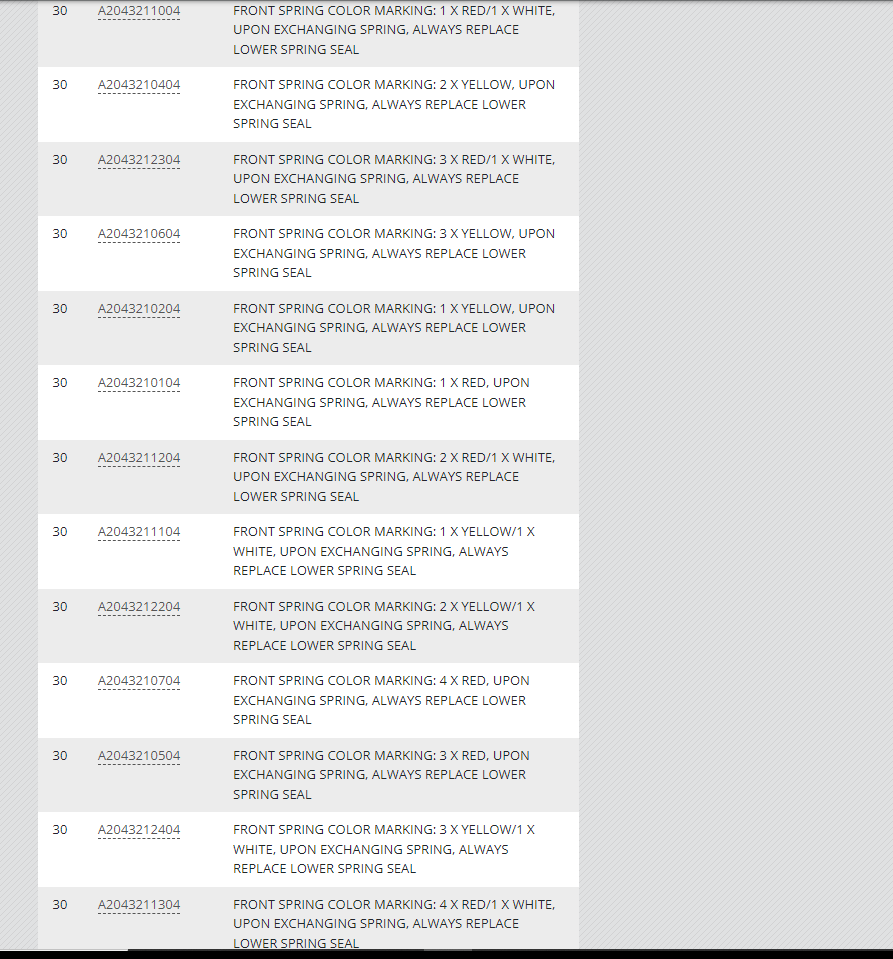

You have the 204.008 based on your vin #.
Here's a link to the 204.008 parts diagrams. The diagrams list every part that will fit so you will have to narrow it down based on which feature yours has, like sport suspension v luxury.
https://truckmall.ru/epc.aspx?mid=1665
thanks man u guys been such a help appreciate it
