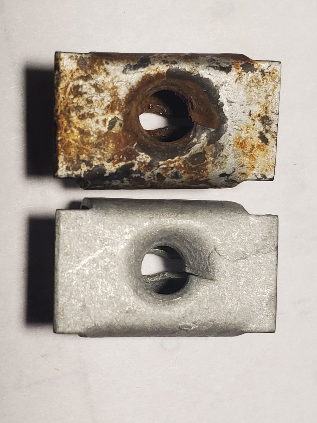

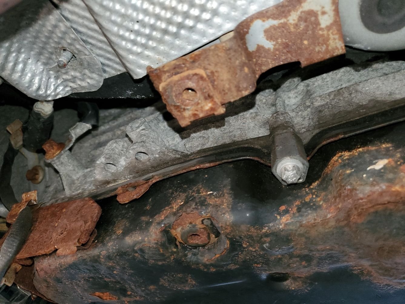

I currently have two of the fasteners that hold the undertray on that are missing. I bought replacement screws and clips, but now it doesnt look like it uses the clips. Im trying to locate exactly what its supposed to look like but not having any luck. I did pull out some odd looking clip that was hanging out of one of those holes, so im assuming its supposed to press in. Im looking through all the parts diagrams but not coming up with how those screws are attached.
The two screws im missing are circled in yellow in the photo below.
Heres what my car looks like now:
Heres a photo of the piece that was hanging out of one of those holes:

Excellent, that looks like what I need, thanks!!! I have the screws with large washers and the larger silver clips but never came across these 0019949845 before. Looks like its going to be a pain and I have to remove that upper panel to get to the hole. I drove the front end on wooden ramps I made out of scaffold planks and could hardly fit my head under there.
I came in to post this question then looked at diagrams and searched for photos of what it could be but wasn't finding anything. I gave up and worked on other things. Checked the oil, cleaned the engine bay, oiled the hood latches, wiped down the underside of the hood since it had road salt all over it, sprayed down some of the bushings under the car with silicone lubricant.
Ive been hearing some noises under there going over some bumps and found those missing screws, I can picture those panels slapping around under there causing the noise. In the mean time I stuck some foam weather stripping between the ends of the panels to see if the noise goes away.

Those speed nut clips usually just push into the metal frame from the bottom, so it should be easy to install new ones. Once in place, the screw expands the folded over parts to hold everything in place.

Thats what I was hoping that new ones will simply push in, maybe I can get away with working them over the panel without removing it.

I will say I can see a difference between the Aliexpress screws and Mercedes screws. The Mercedes are a little heavier and longer by 3mm, they just seem heavier duty. Since I can get them locally for $1 each i'll go with the Mercedes screws if I ever need more. The hole in the old clip looks enlarged and doesn't really hold the screw so I'm guessing the other side was the same, the screws just worked there way out and fell off while driving. My car is also missing the front middle jacking pad part# 0029976186 for some reason so I ordered one today at the dealer for $8.23.

The noises I have been hearing under the car seem to be completely gone now. It was a clacking sound when going over bumps in the road. I pictured it coming from the front drivers side wheel area, like a control arm maybe. Since I shoved the foam weather stripping between the panels I have not heard any noise at all. Earlier today I was driving around and I wasn't even paying attention, I forgot about the noise until I got home and realized I didn't hear anything. Later I was driving and I went out of my way to go over bumps to see if I can get the noise back and nothing. We shall see but I'm sure I would have heard it. I'm thinking it was just the panels slapping going over bumps, without the screws holding them they do move alot. I looked at the photos again and it does make sense.
