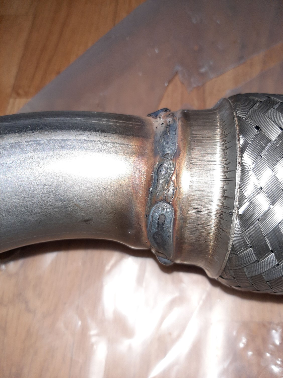

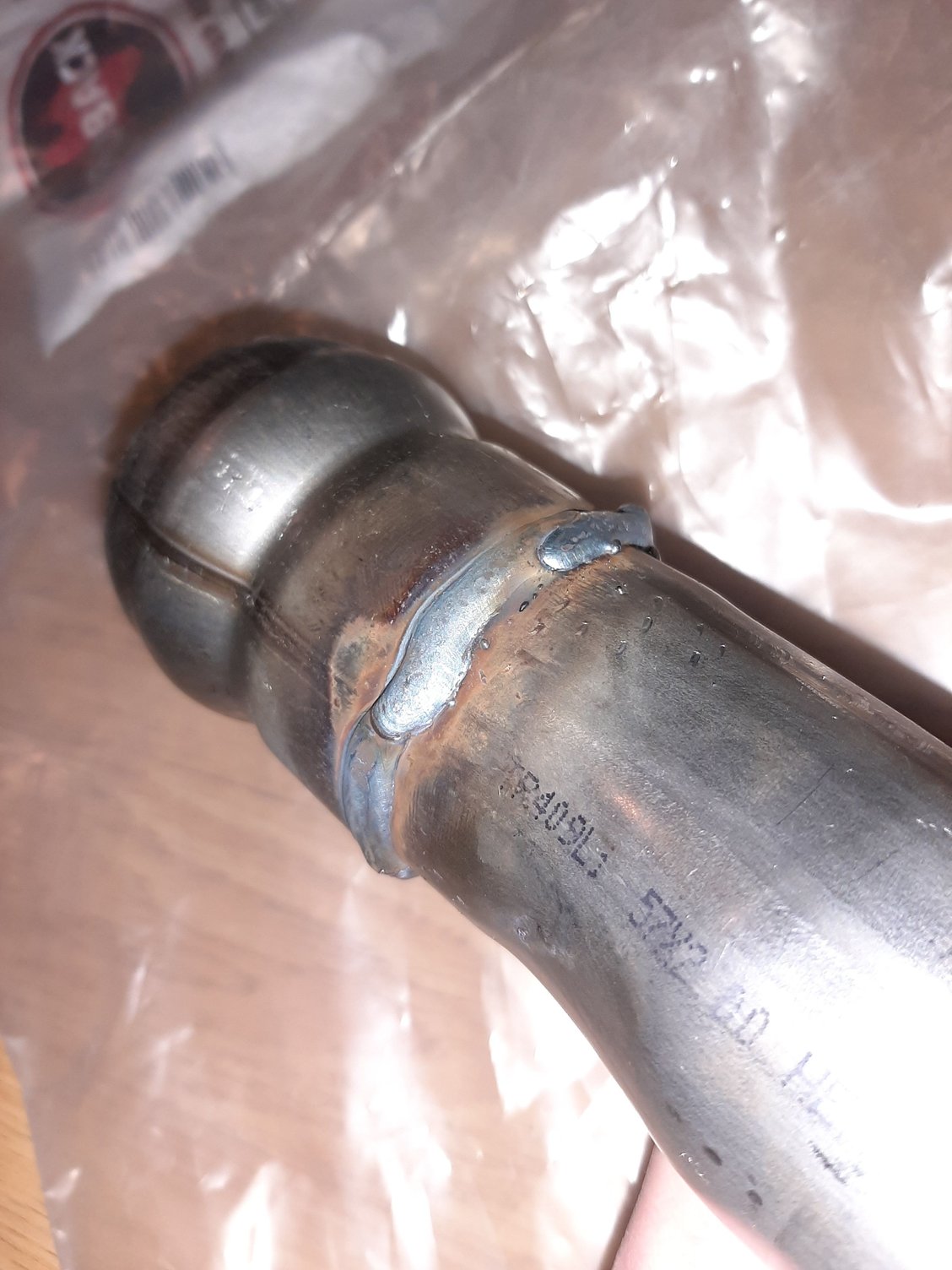

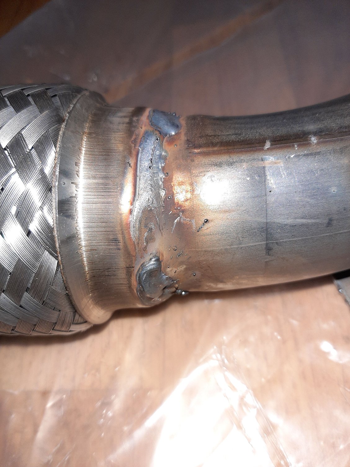

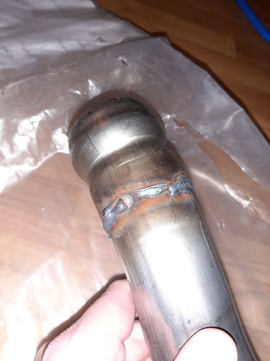

Very bad welds on Redback/" BM catalysts " exhaust system for my 2010 W204 wagon
I ordered center piece exhaust to my wagon, did some research and Redback seemed like a good option. Not too expensive but supposedly good quality. Today I got the exhaust and I have to say I never seen such bad welds on a exhaust. This cannot last long before those hotspots corrode through?
Hoping for some input, what would you do? Return it?

That's gross and unacceptable. I just bought an inexpensive, ~$450 exhaust for my coupe and for a catback on that end of the cheap scale, it has way better welds that what you've shown here. Up to you if you want to send it back.

This looks nice, what you expect on a good exhaust in that range. The centre piece i bought is just oem spec and 220$ but still. Decided not to return it, but just complained to both the dealer and the manufacturer.

Looks pretty bad to me. Where did you buy it from? Im not familiar with redback, or any exhaust company for that matter. Was it directly from that company or 3rd party shop? Maybe the manufacturer would agree that's not up to there standards. If its not what you expected I see no reason to not let them know. Maybe they are not aware it went out looking like that.

True, the weld looks handmade by unskilled day laborer but is it defective ??
Can this pipe hold 100kMi with little efforts: possibly

Got a response from "redback group AB" that they do not actually produce the exhaust, but distribute it. And that i was welcome to return the exhaust. Professional and fast reply from those guys. I left a bad review with "bm catalysts" as they produced it, and gonna leave it at that. Exhaust is on the car and working, albeit with a not-optimal fitment and a presumably short life due to the bad welding.
I guess the morale of the story is never buy Redback.
